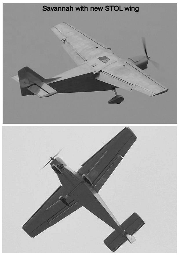

I see viewing the Italian site of the Savannah aircraft they appear to have their new STOL winged aircraft ready for production...
Interesting figures they are giving on the aircraft.
"Savannah ADV Aircraft
Performances
Stall speed = 90 kmh / 56 mph / 49 kts
Cruise speed = 185 kmh / 115 mph / 100 kts
Max speed = 209 kmh / 130 mph / 113 kts
STOL performances
Stall speed = 55 kmh / 34 mph / 29.5 kts
Take off distance = 35 mt / 110 feet
Climb rate = 1200 feet/min at 96 kmh / 60 mph / 52 kts
Wing data:
NACA 23015
Span = 8.0 mt / 26.2 ft
Surface = 9.4 mq/101 sq ft
Root wing chord = 1500 mm / 4.92 ft
Tip wing chord = 750 mm / 2.46 ft
Double slotted flap with leading edge slat electrically operated (manual back up)
Stress rating = +6 / -3 G at 560 kg
Empty weight = 300 kg (284 kg light version*)
* small size wheels / special light upholstery / special light peinture / electronic instruments"
Appears to have the ability of cruising at 100 kts and being able to bring it in at 30 kts...

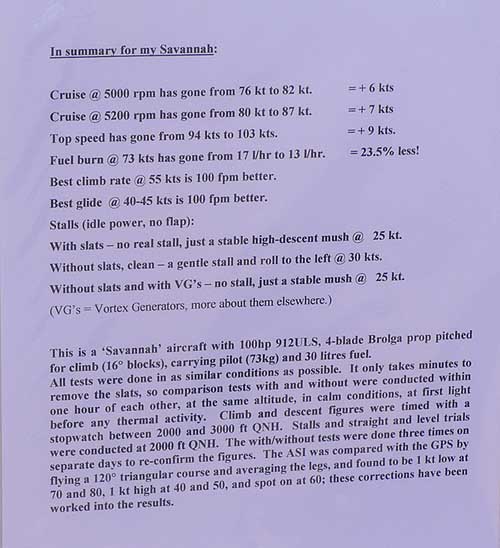

according to the pilot, the stated numbers are pretty accurate, but the
extra cost is a big deterrent for me, i will probably explor this
option,
Removing the leading edge slat alltogether, and installing Vortex Generators on the Leading edge...
as is here

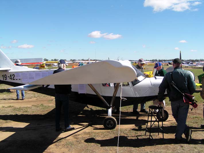

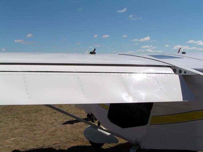

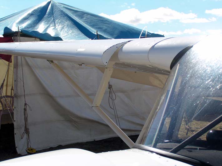

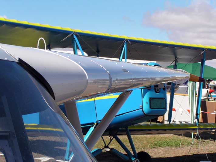

G'day Mark, I was looking mainly regarding the new stol wing and how it's leading edge and flaps are linked, etc... Many thanks.
Rodger
Rodger
Hope these cover what you're after, I've got more but they pretty well cover the same ground. I've cropped, reduced the resolution and increased compression substantially before posting, if you want the original, full photos drop me a line and I'll trickle them through to your private mail.
Mark

just a stupid quick question on the Savannah, although i have bene looking closely at this aircraft and will purchase a kit ASAP, i forget to check weather the Flaps operate over the full span of the wing or just the inner sections??
in other words, do the Ailerons become flaperons when flap is lowered?
and another more out there question, would reflex flap improve cruise speed as it does in conventional wing/flap setups?? would a say -10 deg flap position provide any cruise advantage?
  • 2 weeks later...
Ultralights
If you have a look at myphotos above you'll see a couple of shots with the flap down but the aileron neutral. So I would assume they are independant. One shot has a bit of droop on the aileron but judging from the others I think the stick was over.
Whether you could link the ailerons as flaperons I don't know. Afraid I was just grabbing some photos for Rodger, I wasn't talking to the vendors.
