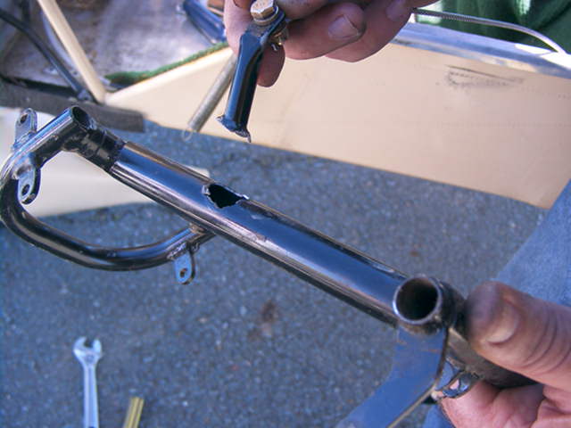

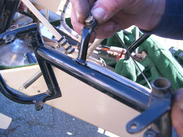

TechMan Posted December 7, 2006 Posted December 7, 2006 The enclosed pics are from a Gazelle whose rudder cable attachment arm broke off on the left hand pedal. Airframe time around 800hrs. No further details known. Might be of interest to others to check their pedals. Please let me know if you find something similar. Chris
TechMan Posted December 7, 2006 Author Posted December 7, 2006 What are you saying Ian? Is your broken too?;) The pics were received by my predecessor, which I just happened to find while 'trawling' through the system and thought it could be useful info. Chris
Admin Posted December 7, 2006 Posted December 7, 2006 NO NO NO - a big thanks to highlight something for both myself and other Gazelle owners out there to pay even closer attention to. On my walkaround I have been guilty of perhaps not paying that much attention to the pedals with only giving them a general look over and not check the welds at the back of them

Guest micgrace Posted December 27, 2006 Posted December 27, 2006 Hi I recall a kit to fix this problem (pedal attachment) that may be of use on the kitfox/skyfox homepage. I know the Gazelle is certified, but since these are so close a possibility?? however a reg 35 may be required plus welder/level 2 /lame http://www.sportplanellc.com/Misc%20Products.htm Micgrace
Guest J430 Posted April 23, 2007 Posted April 23, 2007 WARNING 11th October 2003 I had this same failure on a flying school Gazelle, with my son on board, he never did fly in the Gazelle......anyway I reported this and I believe if you check back the CASA and RAA have both issued an AD or whatever RAA call them. This is a serious issue and was taken very seriously at the time I reported it. I would suggest they be inspected before each flight, especially if its not your own plane and you have no idea on who has been heavy footed with it. My recomendation was to put the tube through the pedal and weld a gusset under the tube. Cheers J;)
