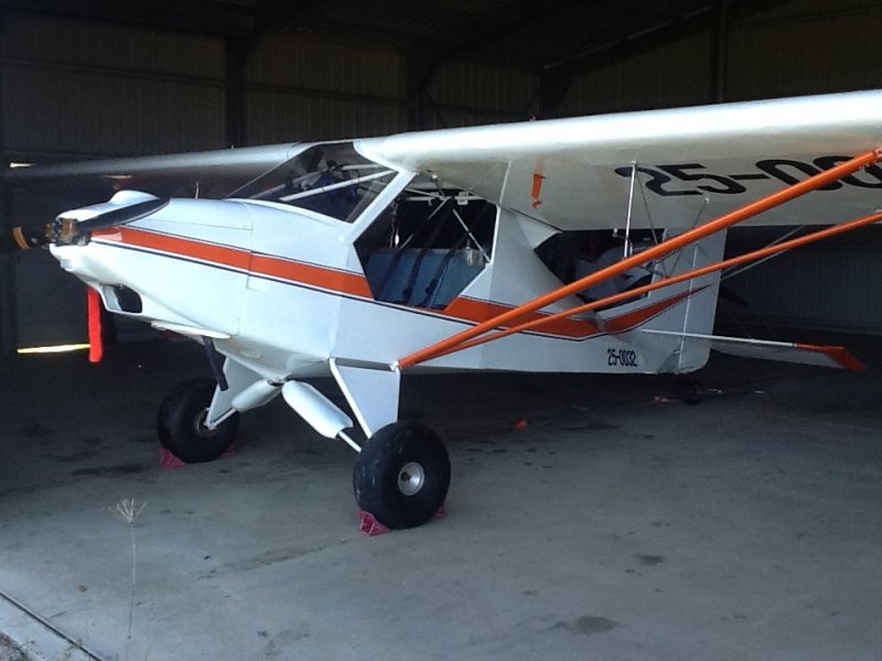

Doug Evans Posted May 17, 2016 Share Posted May 17, 2016 I fly my Lightwing all the time with the doors off make no difference 1 Link to comment Share on other sites More sharing options...
SDQDI Posted May 17, 2016 Share Posted May 17, 2016 I love flying with my doors off in summer. I have had two accidental in flight openings without incident, the first I we were not too far from home so slowed and put flaps out and came back and landed/shut door/ took off again. The second we were further away so slowed down flaps out sides lipped and shut it. One thing that I think should be mentioned though, when flying with BOTH doors off i get a huge reduction in takeoff performance. Maybe not a doubling in takeoff distance but a very noticeable extra chunk of dirt is needed. Obviously some planes will be different but if you are experimenting make sure you are at a reasonable strip! (Obviously I am not encouraging people with certed planes to be experimenting, what I have said in this paragraph only applies to those aloud to experiment!!!!!!!!!!) 1 Link to comment Share on other sites More sharing options...

Doug Evans Posted May 17, 2016 Share Posted May 17, 2016 Little difference if any for the Lightwing one or both doors ! https://www.facebook.com/scott.d.evans.7/posts/10206594018874130 1 Link to comment Share on other sites More sharing options...
