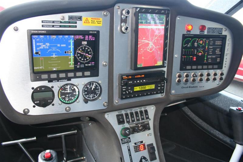

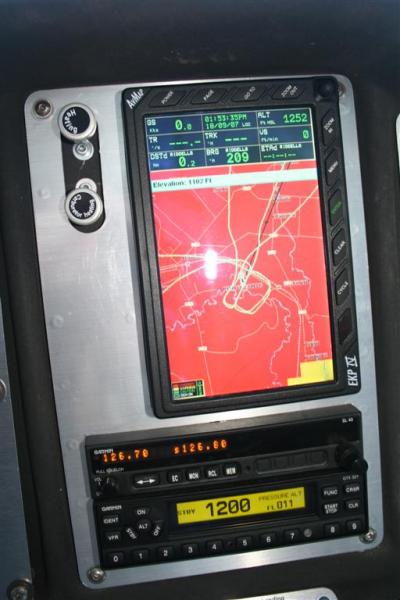

Admin Posted September 11, 2009 Posted September 11, 2009 Clear Prop sells those Panel Docks but here is what I did with the Avmap in my CT and it cost me nothing. First what it looks like: [ATTACH]8650.vB[/ATTACH] [ATTACH]8651.vB[/ATTACH] The Avmap comes with a back plate that has a knee strap through it. Remove the knee strap and cut a hole in the panel big enough for the Avmap and to allow you to mount the backing plate onto the rear of the panel Secure the backing plate to the panel Run a power lead through a switch and Fuse/Circuit Breaker to the backing plate and stick it through the top of the backing plate Mount the external aerial on top of the panel under the screen and run the lead into the panel and again out through the hole at the top of the backing plate You can now clip the Avmap in and out of the panel Hope this helps!
