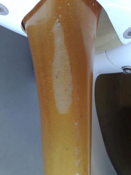

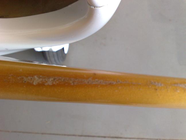

BigPete Posted August 2, 2009 Posted August 2, 2009 My prop on the Jabiru is starting to show a little wear (442 hours in use). i_dunno One side just looks a little worn (varnish? wise) (see pic 1) so I guess its a light sand and recoat, :thumb_up: but the otherside (see pic 2) looks as if the finish is bubbling, creating a cavity underneath the varnish. :confused: Must be plenty of knowledge out there - I await with keen interest. regards :big_grin::big_grin:

Bruce Robbins Posted August 3, 2009 Posted August 3, 2009 Peter, hard to tell from the photo, but the fibreglass sheathing on the prop seems to be starting to de-laminate. I'd get it looked at asap by someone who knows wooden props. If it is de-laminating or coming away from the timber, it can get worse very quickly in the air, and I guarantee it will get your attention. Cheers, Bruce
Guest The Bushman Posted August 9, 2009 Posted August 9, 2009 Prop repair Drill smal holes in surface coat and squirt in Super glue to stop spread of problem and then seal surface of prop as mark is moisture getting under surface as glass is not water proof The Bushman
