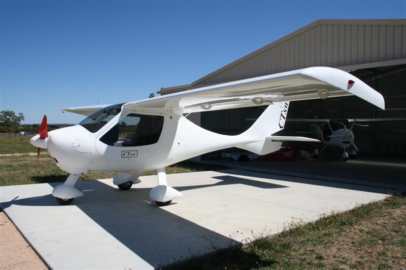

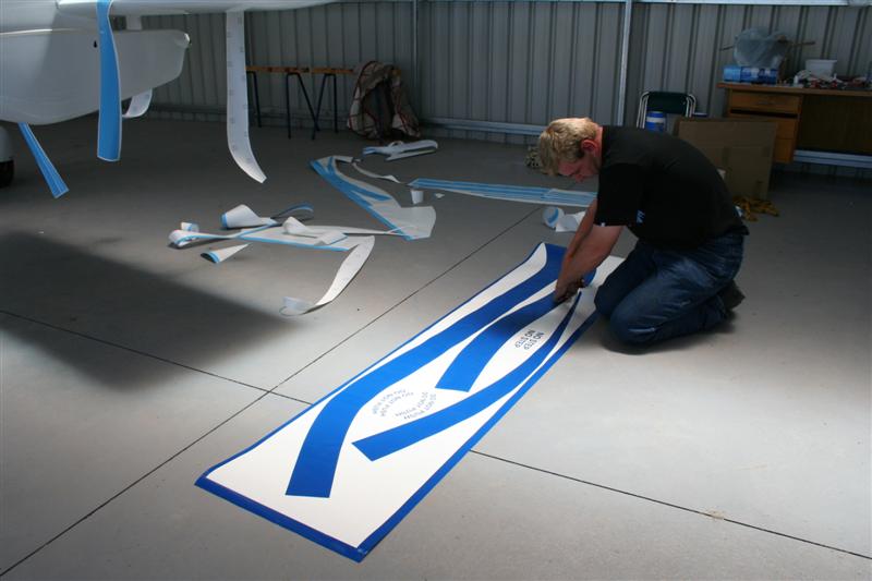

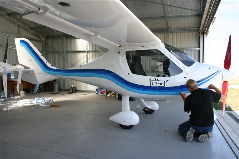

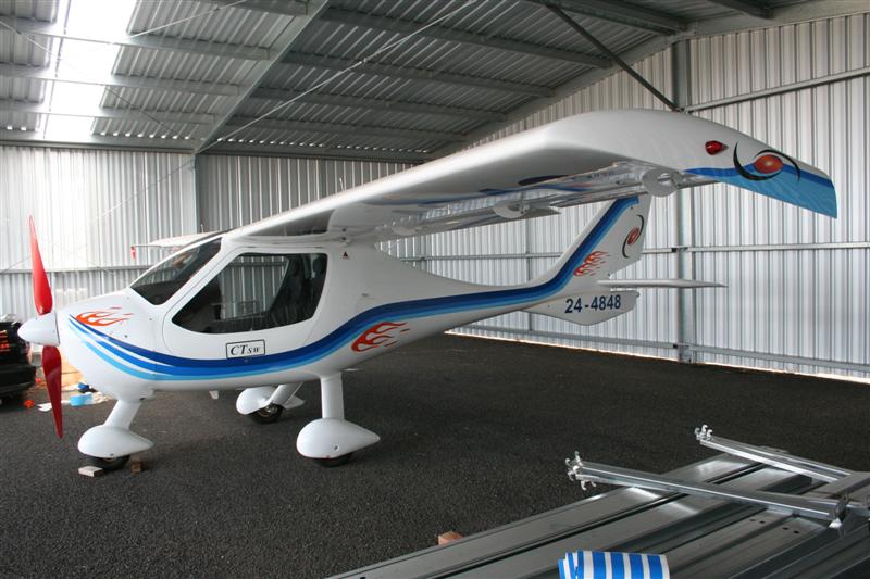

Admin Posted August 8, 2009 Posted August 8, 2009 There are two types of Vinyl - 5 year and heavy duty 7 year. I had all the graphics on my CT done in the 7 year vinyl with no problem by a guy here in Melbourne that also does cars.
