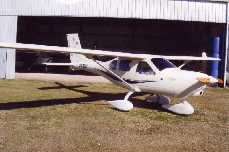

Modest Pilot Posted August 10, 2009 Posted August 10, 2009 I got approval to build proper 3.7:1 teardrop spats as per "Hoerner" instead of the Jabs mudguards. Worth 3-4 knots. Performance now with a Sensnich 60x56 prop at 600kg: Max Speed: 140kn @3100rpm 2800rpm 1000ft 19lt/hr 121kn Egt 690c A bonus was that you can exactly trim the rudder for zero yaw on the Dynon. (but only a for one rpm eg:2800rpm) by slotting the attachment holes on the front spat. Result no more out of balance fuel.
BigPete Posted August 10, 2009 Posted August 10, 2009 Don't be so modest, Modest Pilot. Show us the photos. :thumb_up: regards :big_grin::big_grin:
Modest Pilot Posted August 11, 2009 Posted August 11, 2009 Hopefully a picture will appear in my profile
Vev Posted August 11, 2009 Posted August 11, 2009 Hi Modest, Your pic in your profile is too small … love to see your spats more clearly, can you try and post a larger picture? One of the things I tried was to fit a small trim tab to the back of my front spat, although, like you, it only really worked at one power setting, which I set up at cruise. After I took the front spat off and fitted the hub cap the ac became coordinated at all power settings. Cheers Jack
