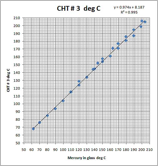

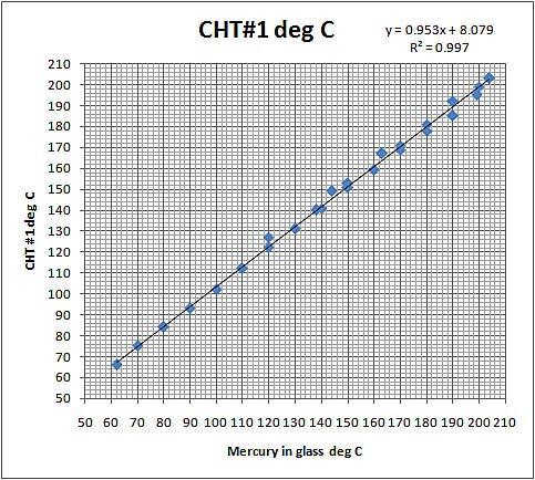

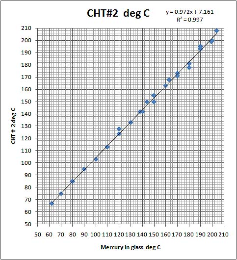

Dafydd Llewellyn Posted October 8, 2014 Posted October 8, 2014 For what it may be worth, here are the results of four CHT calibrations, for K-type thermocouples supplied by Ian Bent, as read by MGL Infinity E-3 gauges, at the end of approximately 3 metre K-type extension leads. The thermocouples had simple crimp-type electrical (plated copper) eyelets which were fastened to the calibration block by 8-32 steel screws. The calibration block was earthed to the system ground, as were the "ground" leads of the E-3 gauges. The E - 3 gauges have cold-junction compensation; the cold junctions were located close to the gauges, i.e. at essentially the same temperature. As you can see, the accuracy was quite good. The graphs are an amalgam of rising and falling temperature data. 1

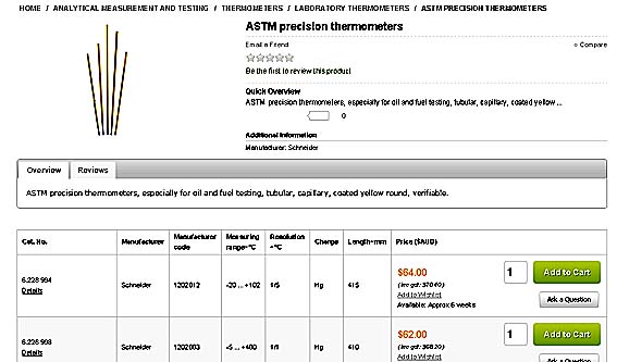

Dafydd Llewellyn Posted October 9, 2014 Posted October 9, 2014 You have to have a reference thermometer, and a block of high thermal conductivity material to which you can attach both the active end of the thermocouple and the reference sensor. The least expensive form of reference thermometer is mercury-in-glass; see attached. However these are fragile and awkward to use. They need a large block, bored sufficiently deeply to allow the thermometer to be entered to its specified immersion depth, and the use of a "coupling fluid" to help transfer heat to the thermometer; and because of the slow heat transfer to the thermometer, the heating rate needs to be low. The results I posted were obtained this way, with a heating rate of around 2 degree C per minute. A more convenient form would be a hand-held meter; however it needs to be a type that uses either a platinum resistance thermometer or has cold junction compensation, if it uses a thermocouple. Either of these features make such a reference thermometer much more expensive; FLUKE make a good one - it's around $aus 1700. http://www.testequipmentdepot.com/fluke-calibration/thermometer-readouts/1523.htm
