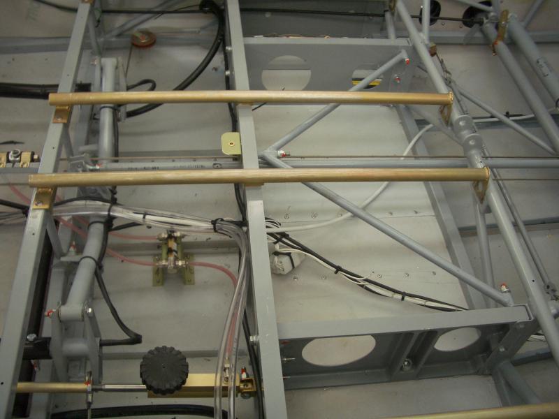

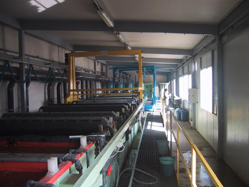

How is you Savvy factory corrosion profed Walter? I have a friend with a Savannah and it is plain old 6061. No corrosion proof from the factory or the builder.

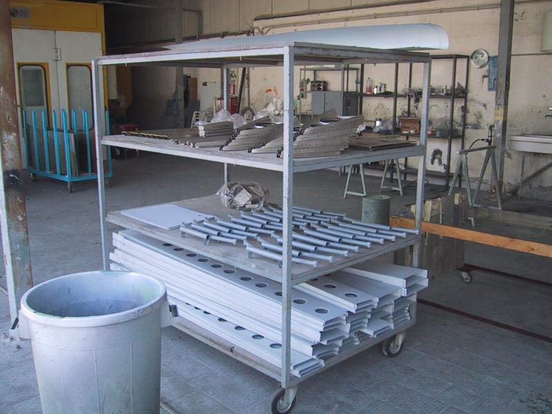

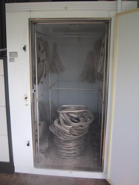

All Tecnams are 6061 and epoxy corrosion proffed. Smaller components like bulk heads are all dipped in anti corrosion vats and anodized before being stored in humidity controlled fridges until assembly.
From the net.
Once the part is proper formed, it most be anodized. Tecnam has a large facility with many tanks. A machine, as seen in the second picture, lowers the parts into the tank. Electricity is run through the tank causing the part to anodize. This helps with corrosion.
The parts are then stored in a bin until they can be treated in the epoxy both.
The epoxy both, as shown above, coats the entire part in an epoxy. The anodization and epoxy not only protect from corrosion but also great a bondable surface for paint.

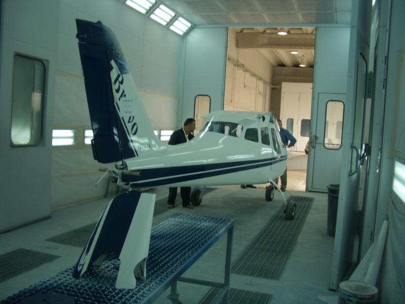

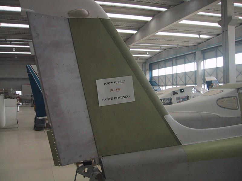

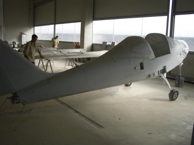

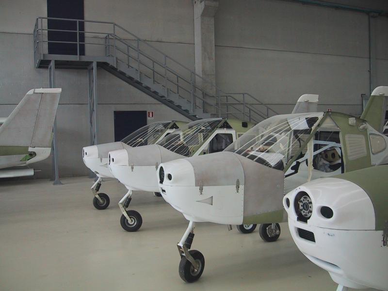

G'day Walter, there are many ways to corrosion inhibit an aircraft, spraying green S*%t everywhere is one way but it also adds weight.
If you hold a torch inside a Tecnam you will see the gold colour of the bulk heads (anodized). If you look at the internal skins, it looks like they are bare, however, when Installing my radio antenna I had to make sure there was a good ground plane so I rubbed the internal skin with a bit of wet and dry. I soon (after a bit of elbow grease) found that they are indeed coated with a fine grey (almost clear) coat.
My friend who built his Savannah got some advice from Bill Whitney. Bill advised that unless the aircrift lives on the coast, and being built out of 6061, spraying etch all over the place is just adding weight.
Photo of Tecnam anti corrosion tanks and other stuff attached. As you can see, not exactly a back yard operation.
617724856_Componentsheldunderrefridgerationuntilrequired.jpg.0f697238a7036e840e3becc43bf9f9c0.jpg

Hi Cloudsuck,
good pictures from the Technam factory. Just goes to show that they apply "grey stuff" most likely etch-primer to theirs. ( the one I saw at Caboolture was shiny aluminium though ) . Undercoat will add weight but lets say you're in the market for a used aircraft of similar age and condition - one is etchprimed all over and the other one isn't. which one would you choose ? all else being equal. The extra 10kg's or so are worth it for piece of mind. ICP ( Savannah ) claims - amongst others -that 6061 does not need to be treated as it is corrosion proof. I would like to see one of these planes 10 years later . Still think that unless they are treated with lots of TLC they will never make the age of our "beloved" Cessnas due to the fact that the metal is so thin and it takes little to eat a hole into it.
