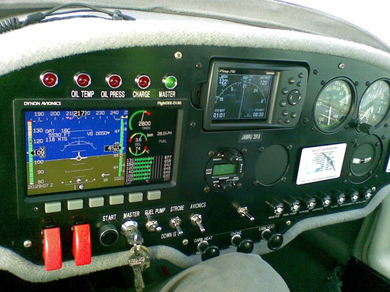

jetjr Posted October 1, 2009 Posted October 1, 2009 I have Dynon D180 in J200, small panel It has Autopilot built in! Fitting servos currently Dynon has a new range out shortly which look better, very flexible setup, able to add equipment as budget allows Idiot lights are hooked to separate senders and still work if Dynon ever dies I would use Garmin or other radio and transponder if I did it again Watch the large panel for knee room if you are tall - I dont fit with them. JR
Captain Posted October 1, 2009 Posted October 1, 2009 Watch the large panel for knee room if you are tall - I dont fit with them. JR I lifted the large panel up so that you can't see any of the area below the windscreen as is visible in your photo, and it fits great with me @ 6' 3". Plenty of knee room. I cannot understand why Jabiru mount their panels so low. Regards Geoff
jetjr Posted October 1, 2009 Posted October 1, 2009 yeah, and they offer pedal extensions and extra seat cushions too, must be a lot of short pilots out there How about pedals which move fwd to use legroom availiable? Mine are spaced 50mm from the firewall on full detent. JR
