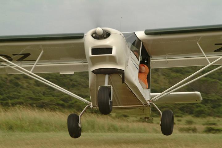

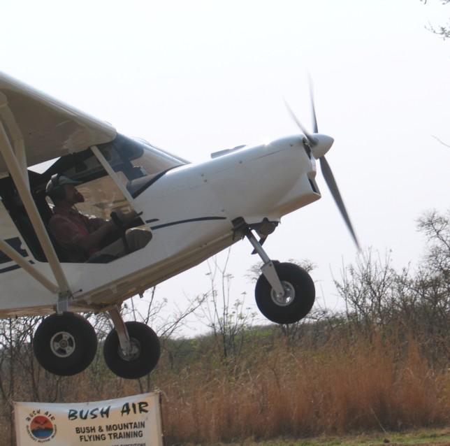

Yiannis Air Posted February 23, 2018 Share Posted February 23, 2018 I did it at local flight low speed and was not any problem at the control of aircraft. To cruise with doors out will be hard because of noise and air that is all over in cabin. In general was nice and funny but not for long. It is helpful if your Co pilot like to take some nice pictures.... Link to comment Share on other sites More sharing options...
xair1159 Posted February 23, 2018 Share Posted February 23, 2018 Some ultralights use an instrument static port inside the cabin or fuselage and flying doors off can affect the ASI readings. If you have a proper wing mounted pitot / static set-up you are OK, if not just check ASI readings with and without doors before you perform a "firm" landing. Seeing your photos, very high AOA flight can give false ASI readings due to positioning error, i.e the pitot is not pointing directly into the airflow. Link to comment Share on other sites More sharing options...

Yiannis Air Posted February 23, 2018 Share Posted February 23, 2018 Technically the above are correct. I believe at local flights and a good knowledge of Savannah can cover instrument mistakes. Link to comment Share on other sites More sharing options...
