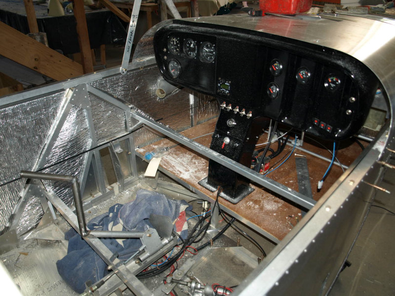

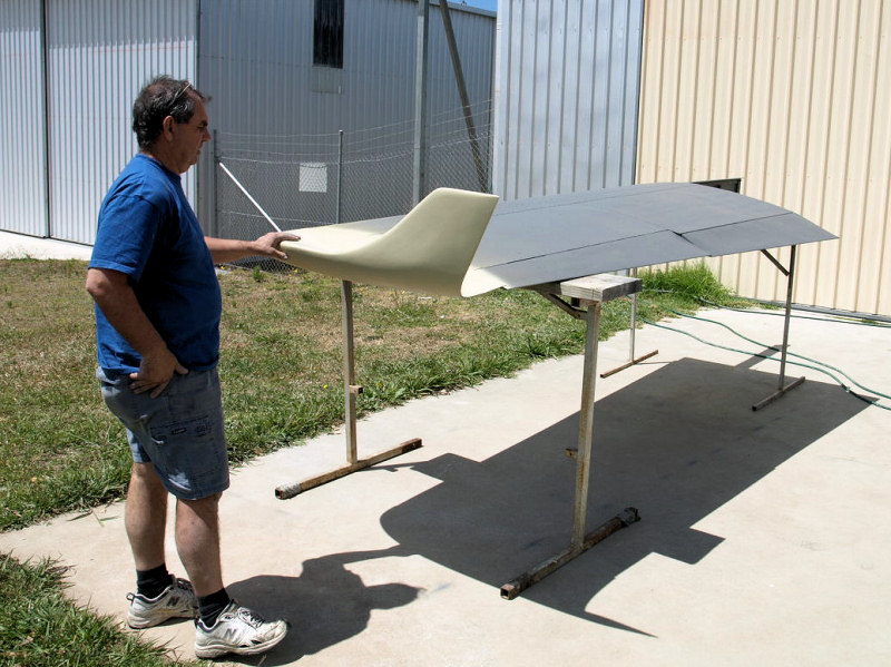

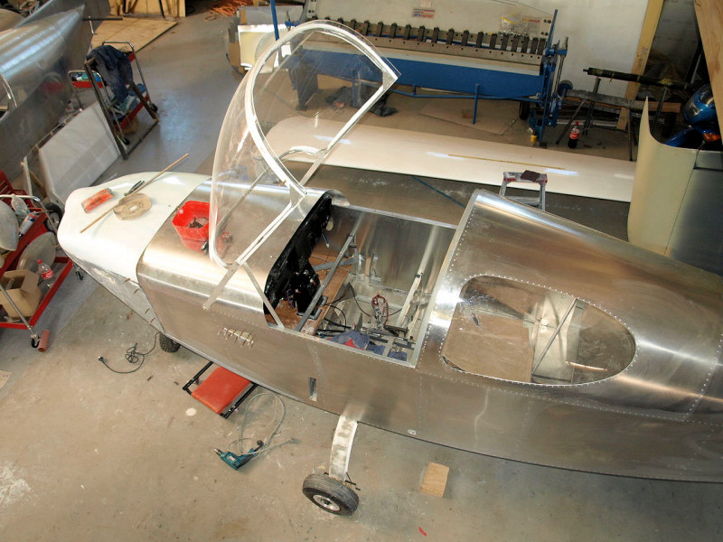

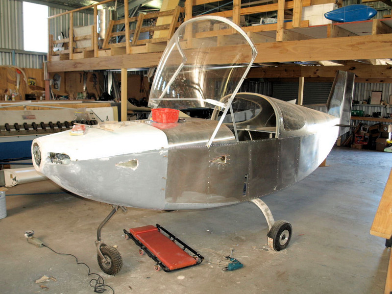

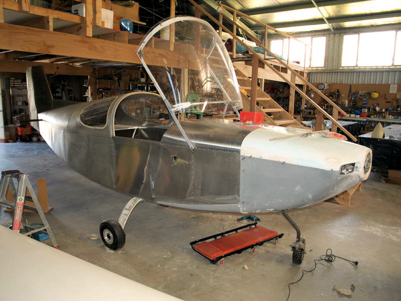

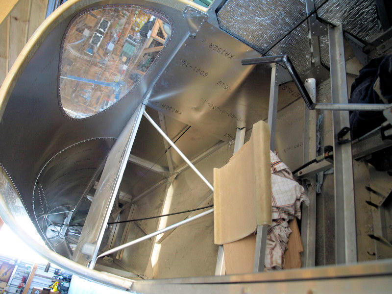

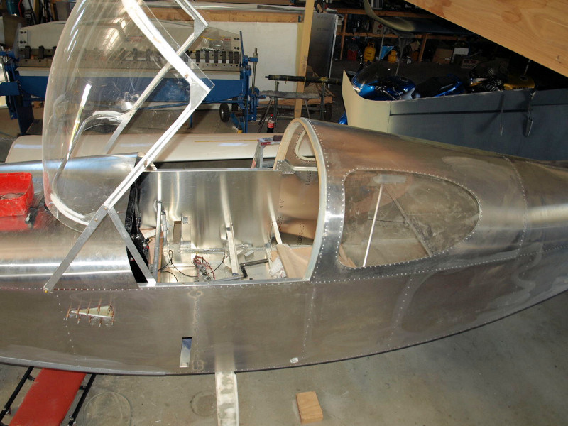

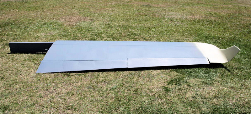

slartibartfast Posted October 22, 2009 Posted October 22, 2009 Garry is rushing to finish the first Cougar - a 4 seat version of the Sierra. It is designed to carry up to 160kg at the rear seats, and the bet is that it will cruise about 120 knots. We won't know for sure until it is finished, but this plane is generating a lot of interest. Here's some photos of where it was up to last weekend. It should be painted soon, and flying before too long. [ATTACH]8963.vB[/ATTACH] [ATTACH]8964.vB[/ATTACH] [ATTACH]8965.vB[/ATTACH] [ATTACH]8966.vB[/ATTACH] [ATTACH]8967.vB[/ATTACH] [ATTACH]8968.vB[/ATTACH] [ATTACH]8969.vB[/ATTACH] [ATTACH]8970.vB[/ATTACH] [ATTACH]8971.vB[/ATTACH]

facthunter Posted October 23, 2009 Posted October 23, 2009 4 seat Morgan. What engine powers that, Ross? Nev
facthunter Posted October 23, 2009 Posted October 23, 2009 jabiru 6 power. Could have guessed I suppose. Might be a bit slow off the ground on a hot day, at AUW.. I'm sure once it gets up it will get going. Not a very big prop. . Nev

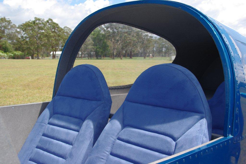

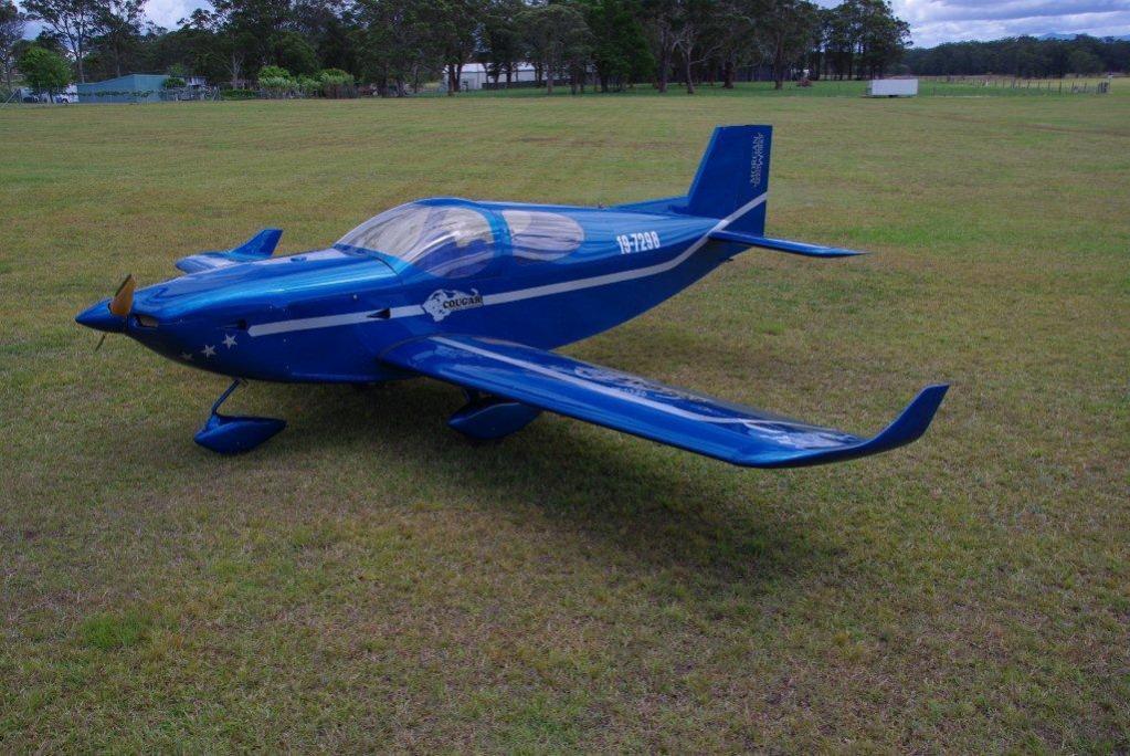

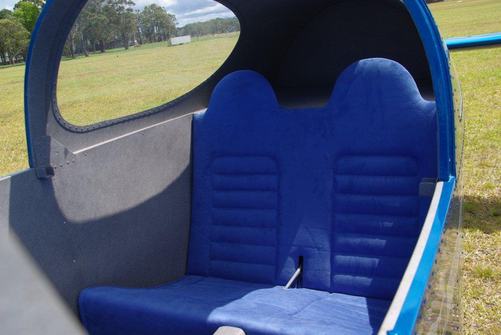

slartibartfast Posted November 1, 2009 Author Posted November 1, 2009 The Cougar is finished. Looks pretty cool. I don't think it has flown yet. Stay tuned. [ATTACH]9006.vB[/ATTACH] [ATTACH]9007.vB[/ATTACH] [ATTACH]9008.vB[/ATTACH] [ATTACH]9009.vB[/ATTACH] [ATTACH]9010.vB[/ATTACH]
slartibartfast Posted November 1, 2009 Author Posted November 1, 2009 Bloody good question. I haven't spoken to Garry this weekend. I know he was hurrying to put it together to get photos and ads in the mags before xmas. There's no seat belts, so guessing it isn't ready to fly yet. I'll get the skinny and let you know.
slartibartfast Posted November 5, 2009 Author Posted November 5, 2009 The answer is:- This one is built as a 2 seat plus baggage - like a J230. Empty weight is only 353kg, so it comes out better than many others with this space. When registered VH, it's good to 800Kg MTOW. Also, this one is set up so that you can't really put 2 adults in the back even illegally, because the CofG would be too far back. One built for VH would have the engine mounted a bit further forward. Builder's choice. The sums are all done, the wing loading is good, looks great, it just remains to be seen how it flies. I'm backing "brilliant". We'll know in a few weeks. You can build it for less than $70,000 with everything included too. No wonder Garry doesn't make any money. Best value on the market.

Guest Maj Millard Posted November 24, 2009 Posted November 24, 2009 Great looking paint job (gloss !!) and great looking canopy...............................:thumb_up:

Deskpilot Posted January 16, 2010 Posted January 16, 2010 This sure is a nice looking plane, EXCEPT for that tail fin. Why spoil a really cool, smooth design with that boxy 'afterthought'? Surley Gary could add some more sexy, flowing curves to finish the job properly. After all said and done, it's the rear end that leaves the lasting image, beit plane or the fairer sex.
skydog Posted January 16, 2010 Posted January 16, 2010 Gary probably wanted to ensure enough rudder authority for his design deskpilot although Slarti says there is plenty enough Sexy plane isnt it? At 150 kts with the bigger engine its a real contender vs an RV kit. :face and heart:
