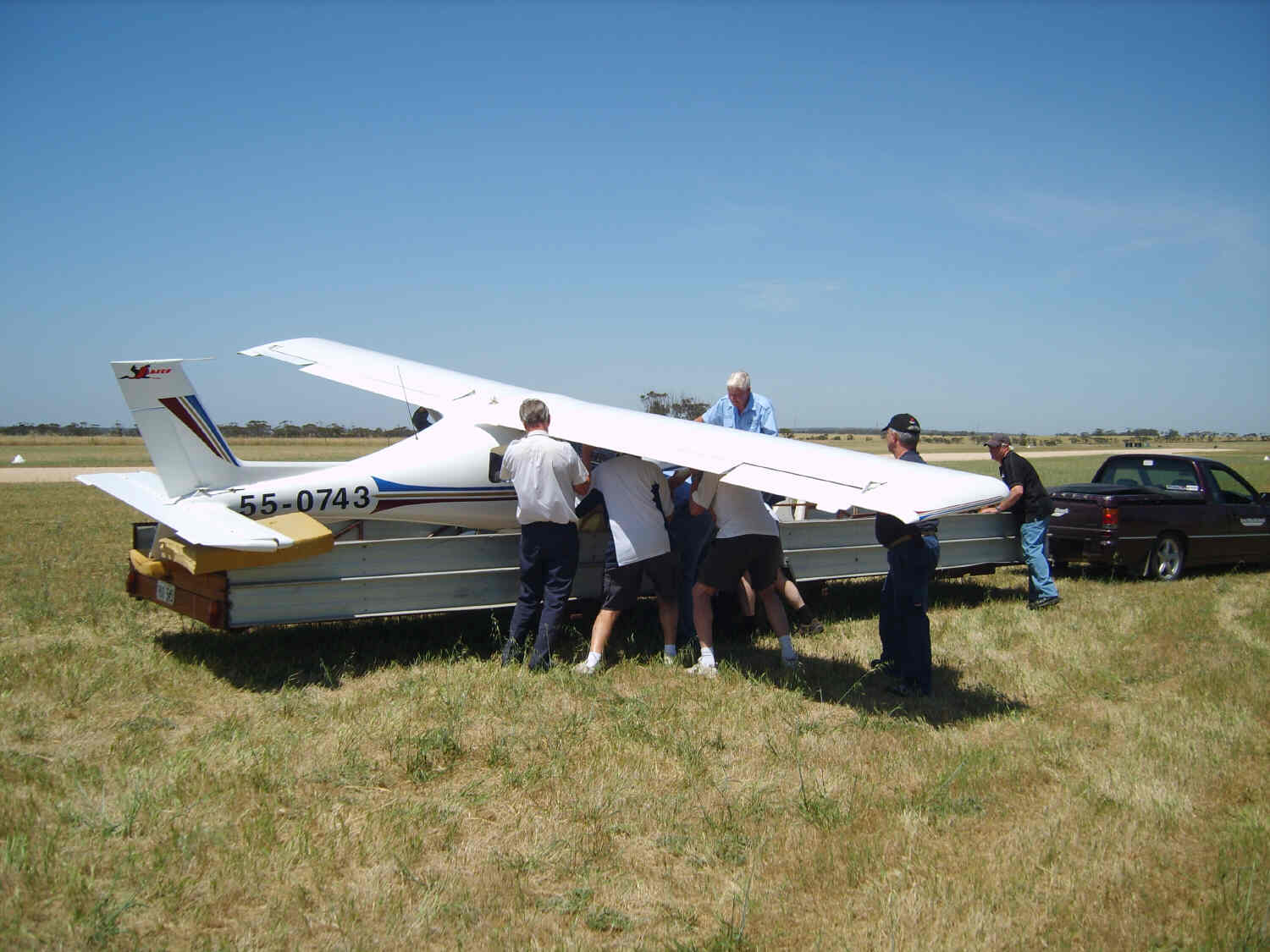

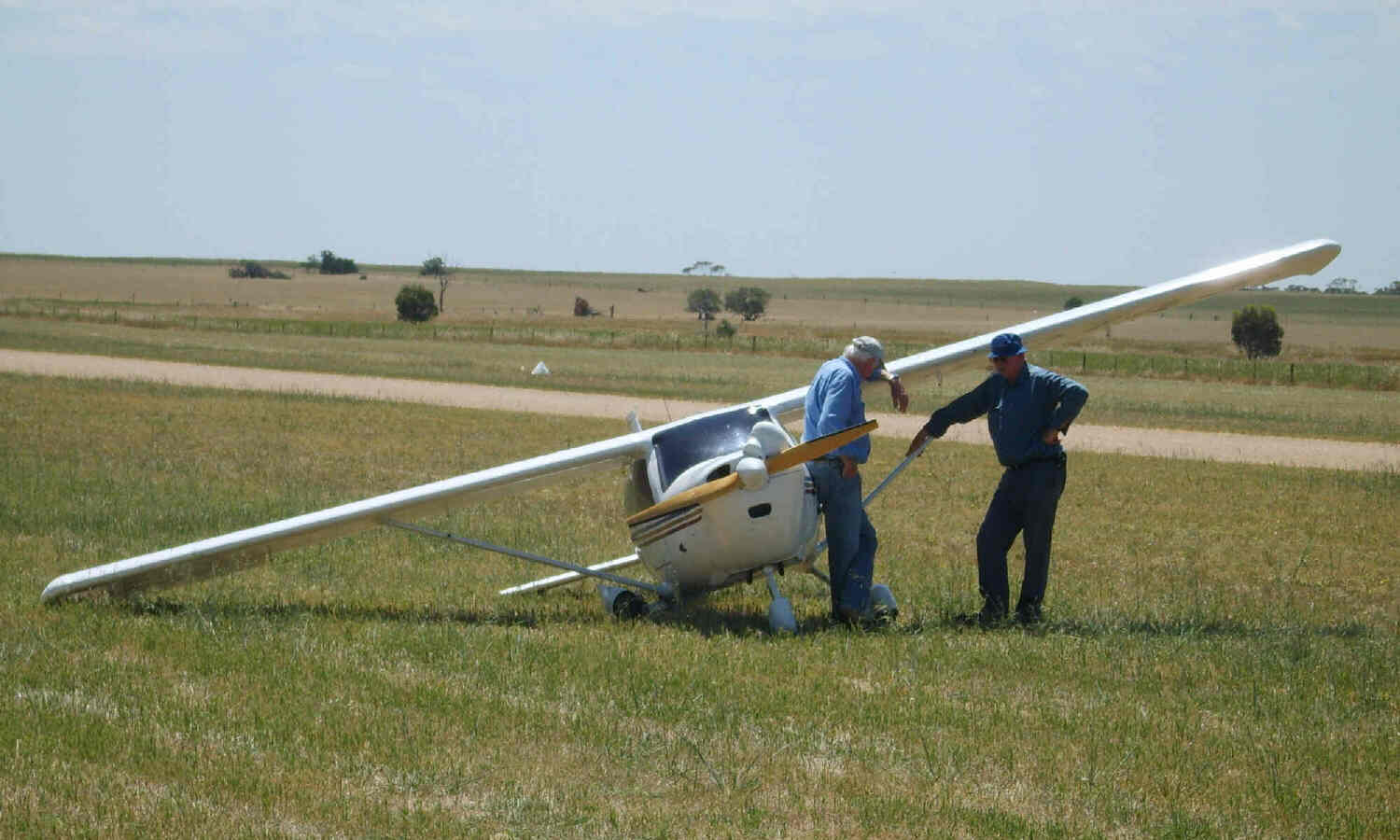

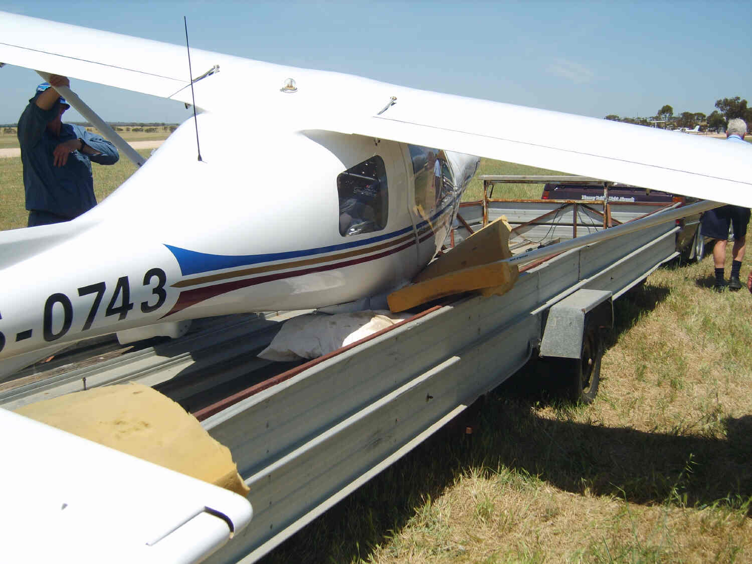

OK, brain fade passed. Photo's attached. The gentlemen in the first picture were not involved, they just helped drag the plane beyond the cones. The pilot was actually checking for marks and debris on the runway.

Aww they just don't look good sitting like that! Wonder why It gave way?
If it's the same cause as the 2 that I've seen, the thread strips inside the nut. It looks like somebody has run a drill bit through it. Luckily neither of these aircraft had wheelspats fitted and required no repairs other than the obvious re-attachment of the landing gear.
As far as I could see, the damage was limited to the spat, a little gelcoat delamination on the wing tip upper surface (could be pre-crash) a punctured nose wheel tire, and the leg attachment area. Couldn't see the actual root of the leg due to fairings. The owner said that he had had the attachment bolt mods done, but by whom I don't know.
As with all things internet - facts are important. As the owner and pilot, the facts are;
1. I have only recently purchased this aircraft and was in the process of working through a maintenance inspection/replacement of all likely suspect items. Next on the list was replacement of UC support bolts and front wheel axle bolt as per Jabiru AD. Turned out that the previous owner and or LAME had not upgraded the bolts to the required 3/8 bolts.
2. The end result was after several successful landings, the aircraft touched down perfectly just on stall warning - followed by a VERY loud bang and a slight dip to the right. Immediate thought was a blown tyre. Stick to left and supported the aircraft along the runway until we ran out of lift. Aircraft then steered right stopping on the adjacent grass. Superficial damage to spats and RH wing tip. 2 POB - all OK. Thanks to the helpers on the ground.
I stand corrected Mc. Heard N.W. state that the AD was in existence and thought you replied that it had been done. Sorry for the mis-understanding.

Jabiru uc bolts
On inspection it was 100% the bolt that gave way. On close inspection the bolt had been failing for some time as you can clearly see where it exhibited "fail rings" leaving insufficient bolt to hold. The nut was 100% intact. The bolts were of the older 5/16 diameter. They have been replaced with Jabiru supplied 3/8th as required. Other than spat damage and some gel coat on a wing tip the aircraft was another example of good a aircraft and of course great pilotage. 011_clap.gif.c796ec930025ef6b94efb6b089d30b16.gif
