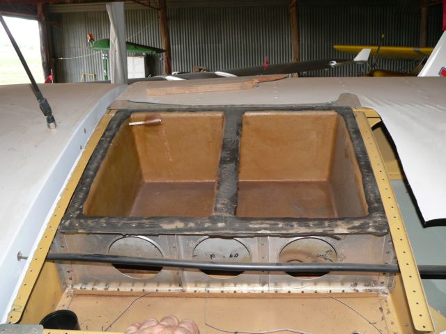

nomadpete Posted November 2, 2009 Posted November 2, 2009 My GA-912 developed leaks in both fuel tanks. The most dramatic was three pinholes half way up the aft face of the tank. The largest hole was almost 3mm diameter. Was this a result of a chemical reaction from the fuel? Has anyone heard of similar problems with any aircraft? Has anyone heard of anyone installing fabricated alloy tanks to replace fiberglass ones? Anyone who knows Lightwings would appreciate how much work is involved in replacing the integral fuel tanks. Safe flying, Peter

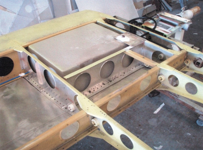

nomadpete Posted December 9, 2009 Author Posted December 9, 2009 Yes, sadly these tanks are an integral part of the wings. They sit between the top skin and the bottom skin and you couldn't slide a tank in from the wing root due to the root rib.... pic shows tank with top skin removed. My only option is to build alloy tanks and rivet them to the top skin just like the old glass ones.

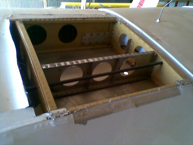

Guest nunans Posted February 28, 2013 Posted February 28, 2013 Gday again Peter, I found picture of my tank in my lightwing. The aircraft was stripped, inspected, frame repainted and aircraft recovered five years ago (by the previous owner) so i'm all good for the airframe inspection. However after all that work was done the tank still leaked and the owner must have just given up and let it leak for the past 600hrs.... I'd love to be able to fix it without cutting the covering and having to get somebody to recover the wing (matching paint color, trim color etc) but i'm doubtfull that I will be able to fix it witout getting it out. Mine looks like fibreglass tanks (GR912 by the way) serial 93 It's dissapointing, out of the three lightwings i've been in, they all either have had or did currently have leaking wing tanks, and that doesn't include yours and Maj's so actually Every lightwing I know of has crappy fuel tanks both aluminium and glass.
nomadpete Posted March 3, 2013 Author Posted March 3, 2013 OK. Thanks for the pic. I know of one local GR582 which has a leaky tank, too - they are a removable type in the leading edge of the wing. Yours appears to be exactly the same tank arrangement as my GA-912. Several points: 1. Your wing seems to have a alloy skin on the top that goes past from the root rib, to at least the second rib (mine only has a top skin over the fuel tank - from the root rib to the first rib in. 2. Your wing does not have a metal skin on the bottom of the wing. Mine does. But then that must be a difference between GR wing vs GA ? I noted that apart from the pinholes that had developed in the sides of my tanks, they both had evidence of attempted repairs to the fuel drain fittings and some of the points where the fuel tubes entered the tank. I would suspect that there was never any semkit around the interface between the alloy tube and the f'glass tank. Nor around the fuel drain threaded fitting embedded in the bottom of the tank. Bound to eventually let go and weep. The insides of the tanks also had signs of resin lifting where things had been glassed in, and disturbingly there were flakes drifting around loose in the bottom of the tanks. The only way to fix it properly is to take the offending tank out. Make sure you do a liquid pressure test overnight before putting it all back together.
