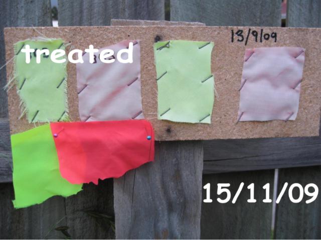

tassytriker Posted November 15, 2009 Posted November 15, 2009 Over the last few years i have built a few windsocks from ripstop nylon for the private strip i fly out of hear in tassy,they only last a 4-5 months before the uv here deystoys them even after a few weeks the once brite socks that were visable for miles away become faded. After reading some of the discussions on uv protectant available i thought i would put sum to the test for my socks.So i shelled out $40 for one of the popular brands and sooned recieved it via mail.I conducted a experiment by nailing a few samples of flouro ripstop to my fence in direct sunlight coating 2 of the samples and leaving the other 2 uncoated following directions strictly.The samples have been there for around 8weeks now and i have taken photos at around 4 week intervals and in my experiment i have found that there was absolutely no visable differences in the rate at which the samples faded treated or untreated?So unless someone can demonstate otherwise i wont be using on my wing? Gary [ATTACH]9189.vB[/ATTACH]

tassytriker Posted November 18, 2009 Author Posted November 18, 2009 Gday paul I was aware that these products can have downsides as you mentioned and there may be some that actually work,the product I used i have heard discussed and know that some people have tried on their wings and the point i was trying to make i guess that is if you havent seen real evidence that it does provide uv protectant apart from the fact you are creating these other issues(diffuculty of repair,mildew etc) you quiet possibly arent getting any uv protection at all? regards gary
