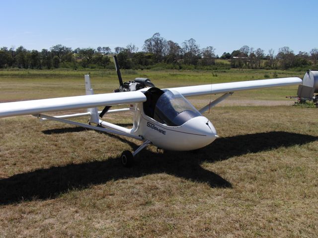

mechfx Posted December 22, 2009 Posted December 22, 2009 2 hrs of supervised ground runs today, I'm exhausted. the first time the tail lifted I thought I was going over ! but got used to it after a while. I've been told it will feel like it flies low in the nose compared to a Jab anyway. I have booked a lesson in a Lightwing taildragger tomorrow so am looking forward to another adventure. Anyone have any recommendations when trying a new type for the first time ? cheers, Art
Guest Maj Millard Posted December 22, 2009 Posted December 22, 2009 Take as long as you like on runway work. Finally when you feel ready, use the power to fly it, and as soon as it breaks ground, reduce power, to just fly a couple of feet above the runway. This is all assuming you are on a long runway of course. It sounds like you were pretty close to flying anyway. With enough speed going over it, the wing will find flying position, and that's probabily why the nose went down. Unless you are doing a heap of knots, it's probabily not going to do much damage if the nose does touch the ground. Richard Faint was the man to talk to in regards flying Saphires, last I heard of him he was in the Watts bridge/Tagoolawah area. Sounds like a good idea to get some Lightwing taildragger time ...good luck..............

mechfx Posted December 24, 2009 Author Posted December 24, 2009 thanks everyone thats exactly the sort of info I was hoping for. My Sapphire is one of the early ones , so no flaps and semi open cockpit. The motor (377) is in the upright position so is inducing a bit of drag. I'm hoping it wont want to float too much. A lot to learn.... cheers Art

pylon500 Posted February 25, 2010 Posted February 25, 2010 While the Sapphire is probably easier to land than a Lightwing, you need to be aware of the very light controls in the Sapphire, and the possibility of over-controlling. If it's a stock Sapphire, hold the controls gently, but NEVER let go of the stick. An anti-servo trim system is a good mod for a Sapphire. Arthur.
nong Posted April 3, 2010 Posted April 3, 2010 The tailplane is mounted very close to the ground and you're at the other end. Easily damaged against obstacles if you forget. Saphires are sometimes divergent in pitch.....mildly pitch unstable. No big deal, slow divergence, but P500,s advice to keep a relaxed hand on the stick is good. The flat efficient glide means that you will be lower for a given distance from your touch down point than you might be used to. Look out for obstructions! Take plenty of juice so that you can go around as often as necessary without worrying about your fuel state. Take note of the pilot weight limits....you may need ballast or a crash diet. Relax and take your time. Let the plane do the work. Enjoy! Nong
