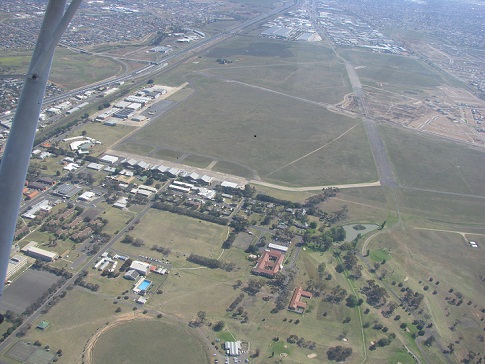

djpacro Posted January 3, 2010 Posted January 3, 2010 Seems that kaz is taking the northern route but my choice would be the southern route per donkey. Altona baseball stadium is not easy to identify unless you know it well but Laverton AFB should still be recognisable (see recent pic attached) by then. Set sail towards Ballarat (on a nice day you can see the bumps of a couple of mountains up that way). Mount Cottrell is also hard to identify so when you think it is under your right wingtip look to the north and you should see the town of Melton with the airfield nestled against the foothills a bit further away. As you track towards it the two reservoirs on the left will re-assure you. I'll be going to Echuca instead for the Australian Light Aircraft Championships.
