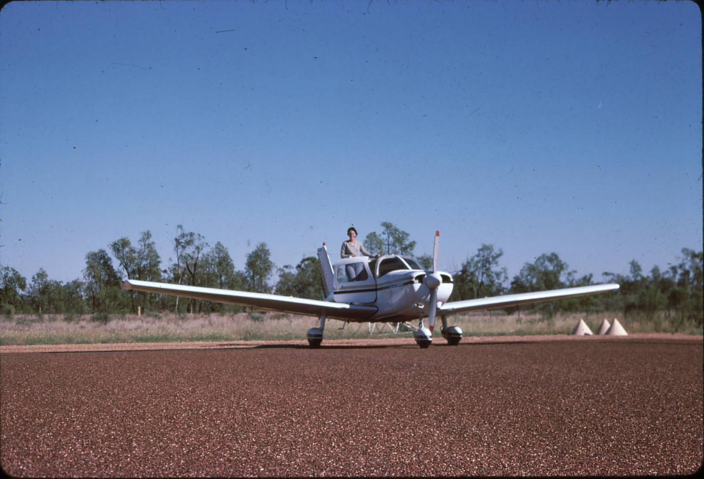

turboplanner Posted January 2, 2010 Posted January 2, 2010 Warrior parked at Lightning Ridge with the prop vertical.......because I can...
