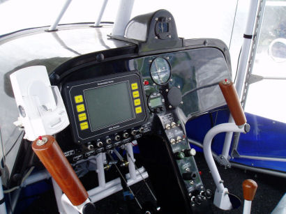

Hey Scotty - That is very nice!
Looks like you have done a precision job on the build too. View from that cockpit must be real good..
What is the configuration of the "glass" panel you have there?

The glass cockpit instrument is a Stratomaster Horizon XL. Available in Australia from http://www.lightflying.com.au
It's not bad, but I had a bitch of a time with it initially, having a dodgy sender unit. This unit sends all the info from all the probes in the engine bay via one cable to the cockpit, and caused all sorts of hell trying to work out the problem, with readings going haywire. The new unit pretty much solved it all, tho. I chose it because it has fuel level, fuel flow, 4 EGT 4 CHT, and the rest. Sounded like a good idea at the time, monitoring everything.
Now, I admit it's only done around 10 hours so far, and I have yet to fly in it ;) Still in test flying stage. Next time, tho, I'd probably put in a digital EMS and analog flight instruments. The glass panels have a lot of info crammed into a fairly small screen. You can actually redesign the screen with as much or as little on it as possible, via your PC, which worked well, getting rid of some of the more obscure info.
