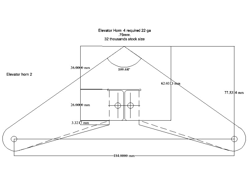

ausgee Posted November 20, 2010 Posted November 20, 2010 cnc cutting fittings for pietenpol I am drawing the metal fittings so that they can be cnc cut. There are several snivels about some of the tabs needing to be lengthened so that the bolts go in easier. Has anyone got a list of where the problems are? Got the official plans this week from the Pietenpols.
