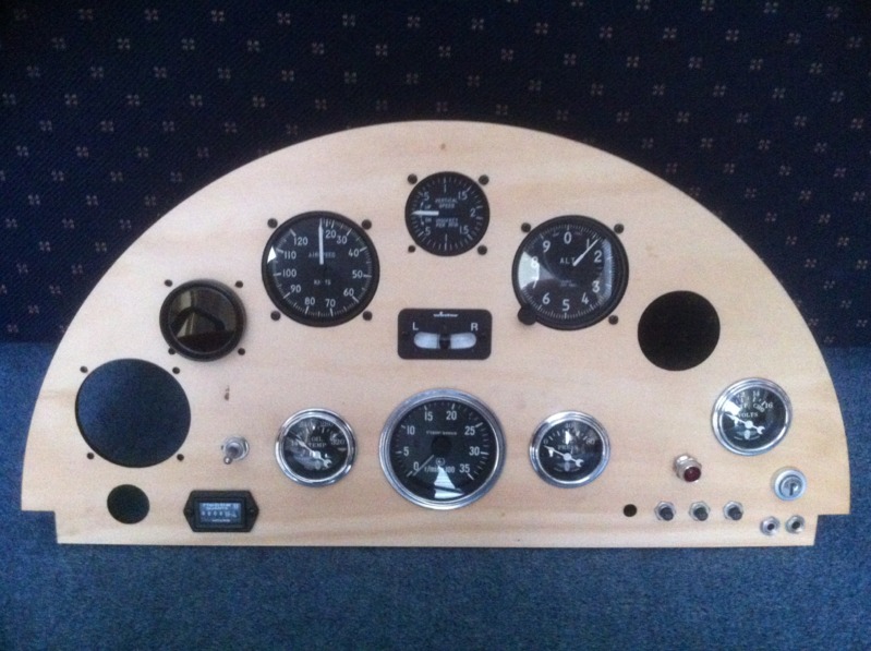

How's this for an instrument panel?[ATTACH=full]14260[/ATTACH]

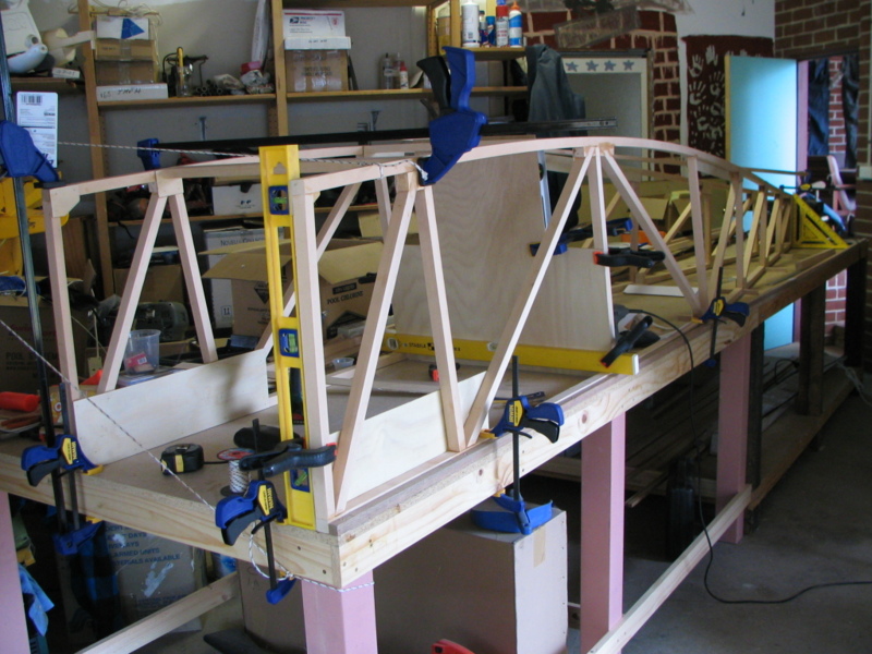

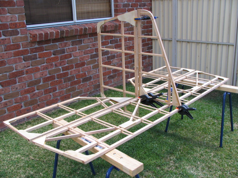

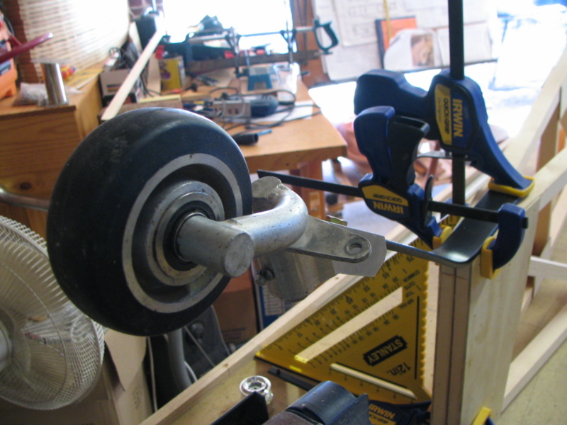

Its been a productive month! Building the fuselage and even had a trial fit of the tail wheel today!

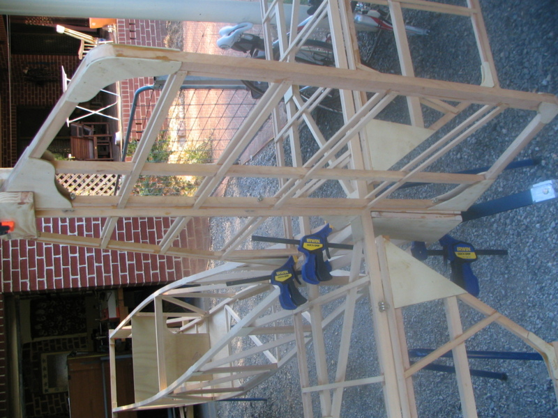

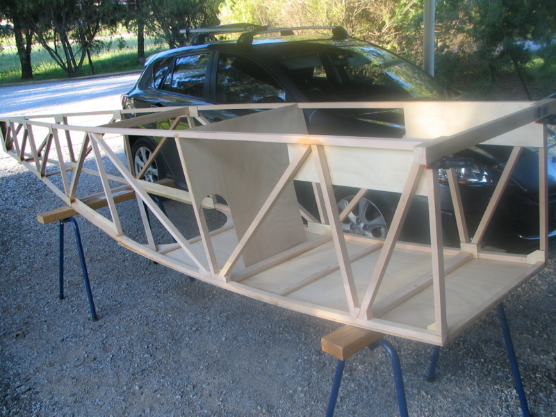

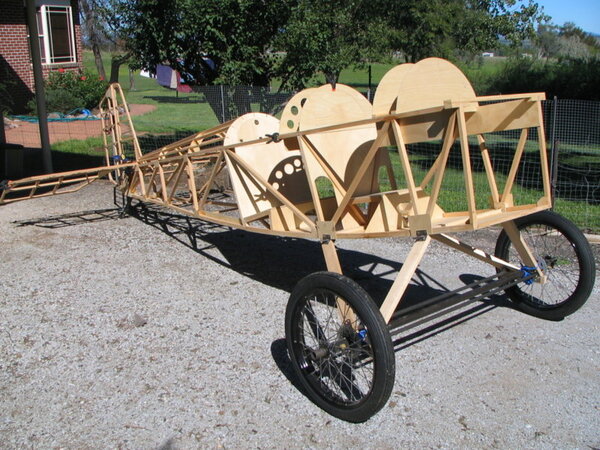

Milestone tonight!...Removed the fuselage from the build table and turned it up the right way! Tried on the tail sections and even gave it its first taste of daylight! Now time to fit it out!

Scotty,
Before you go much further, make some enquiries about enlarging the gap in that bulkhead between the cockpits. Ask on the Pietenpol forums if you can fit a cross cockpit stringer at the height of the curved cut-out and fit diagonal stringers from the lower fuselage cross member to the newly fitted cross cockpit stringer. Then cut away the plywood sheeting to enlarge the hole for your feet to go through.
I found that with the foot hole as narrow as you have it, I couldn't get my No 10's through the hole. or get enough bend in my legs to get out. I'm sure that this modification won't reduce the stength of the bulkhead, but will make getting in and out easier for the pilot.

Scotty,Before you go much further, make some enquiries about enlarging the gap in that bulkhead between the cockpits. Ask on the Pietenpol forums if you can fit a cross cockpit stringer at the height of the curved cut-out and fit diagonal stringers from the lower fuselage cross member to the newly fitted cross cockpit stringer. Then cut away the plywood sheeting to enlarge the hole for your feet to go through.
OME
Hi Mark...im a step ahead of ya...lol! I made the cut outs higher and wider than the plans. This is a common suggestion from fellow Piet builders
