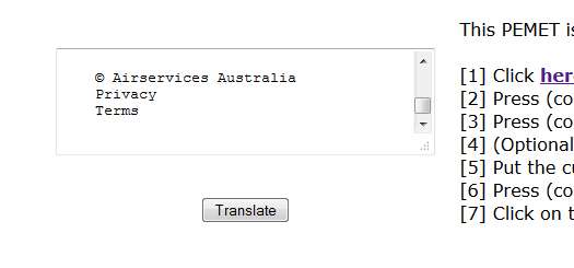

ianboag Posted February 27, 2013 Posted February 27, 2013 This error means that you have not got the copy/paste quite right. The program is looking for the briefing UTC time in the content that has should have been pasted into the "PASTE HERE" square. I have now changed things a little so you get a slightly friendlier message that tells you the copy/paste was incomplete. Unfortunately that's about the best I can do. It's clunky, but there is no other way (that I know of) to get the data into the pemet page (unless I pay Airservices some money like Champagne does). As a bit of a clue, when you do the paste (ctrl-V on a PC) you should see a little bit of the briefing (the end of it) appear in the paste window. Usually (not always) it looks like the attached pic. Also, if you can still see the "PASTE HERE" message after you think you have pasted it in, then the paste operation has not happened. If the "PASTE HERE" message goes away but things still don't work .... open Notepad (or some other text editor) and try pasting into that. This is just to confirm that you have the "copy" bit right. When you paste into an editor you should see the entire briefing that you have selected and copied. Just a bit of finger trouble ..... perservere ... it works. PM me if the problem persists. IB 1
