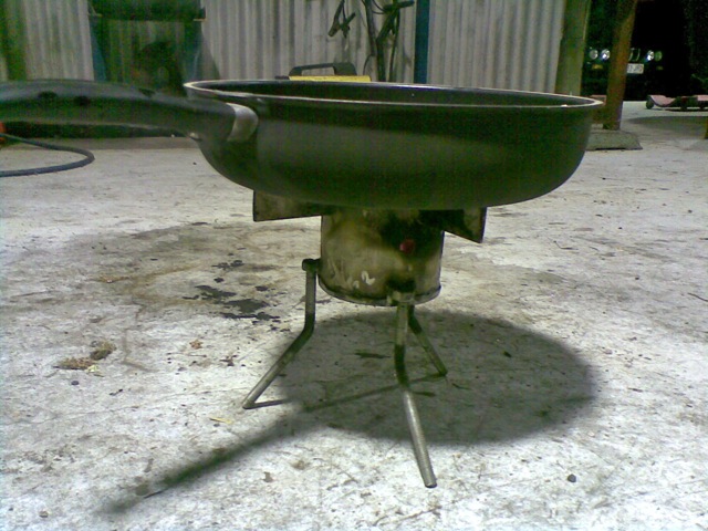

I'm pretty agricultural you might say, but it works....
I've made this thing, put dirt/sand in the bottom, and poor whatever you fancy into it, just enough to soak into the sand to make it moist.
Light it up, and away she will burn, depending how much sand, and how wet you make it as to how long it will last.
Metho burns clean, but doesn't last long, petrol works a treat, kero smokes like a train, etc etc...
The legs screw off, and she'll all pack up, weighing 600grams or so I guess.
Sorry the pic's are shocking quality/light, took it on my phone in the dark, not a good combination.
