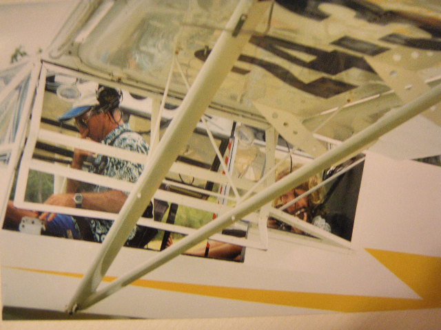

Guest Maj Millard Posted March 26, 2010 Share Posted March 26, 2010 The normal take-off proceedure in the Slepcev Storch is with full flap (flaps on, only 2 positions, off or on) per the Storch POH. Obviosly the same for landing.......................Maj.. Below: Mmmm why is that control stick moving foward on it's own ???? Link to comment Share on other sites More sharing options...
