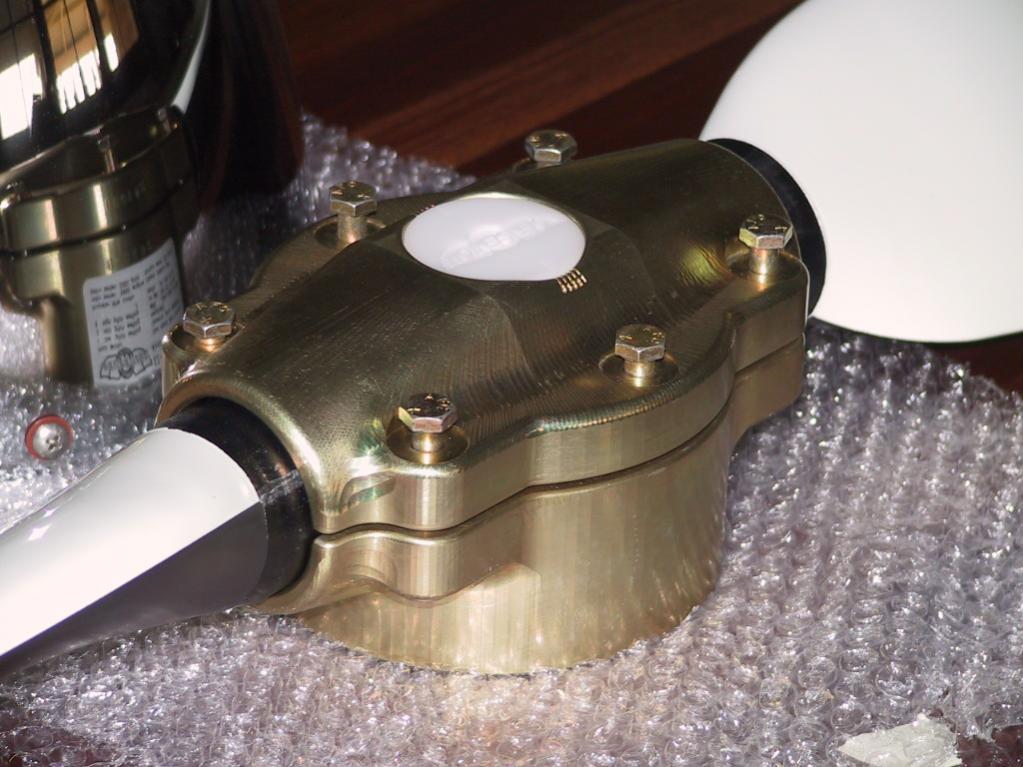

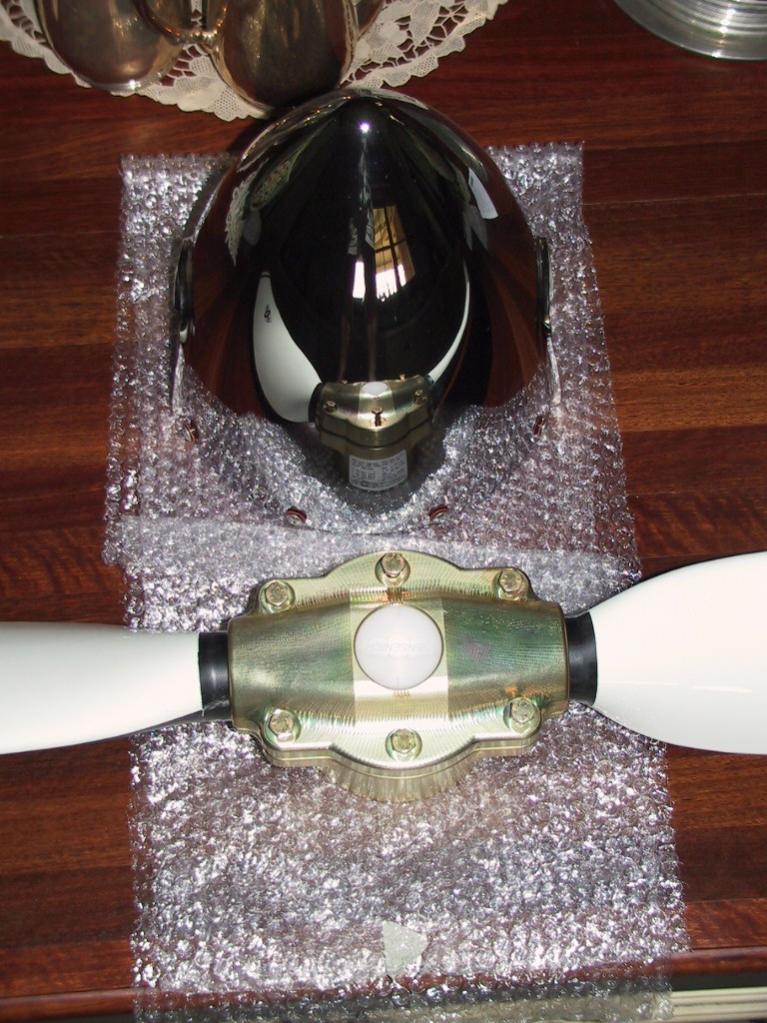

Galvanic action was my initial thought too Maj, for the reasons that you have stated, except on mine there is also a SS backing plate and a chrome covered aluminium spinner to add to the galvanic soup.
I doubt that your grease fix would be enough as the steel bolts that connect it all together are contacting the steel prop flange and the alloy boss.
Attached FYI is a pic of my Sensenich boss, looks lovely now but should not be too hard to keep an eye on through the spinner and when checking bolt torques.
Regards Geoff

Captain, have not seen one of those in the flesh, but from your photos it appears to be a well engineered item, and from the finish may have been alodined ?...which will help guard against corrosion.
Ozzie, Yes works very well for isolating two metals..........................Maj..024_cool.gif.7a88a3168ebd868f5549631161e2b369.gif
