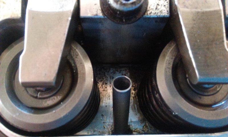

derekliston Posted May 4, 2017 Posted May 4, 2017 I currently have the same problem with cylinder 4 on my engine. It took me a while to figure out where the oil was coming from and it is not a massive leak but it is a leak and I'd like to fix it. Anyone know why only one cylinder is doing it, what causes it and how to stop it. I have to say that I haven't found the factory particularly helpful. Hoping that someone on here knows the answer. To paraphrase an old TV ad "Not happy Jab!" This engine has done 25hrs since a rebuild by the factory to nil hours after a prop strike. In that time I have had to fit two new distributor caps a new (one mag) set of ignition leads and this persistent oil leak!

derekliston Posted May 4, 2017 Posted May 4, 2017 Thanks for the responses. If in the space of 8hrs I can find two other people with the same problem then it beggars belief that the factory is not aware of it because if there are three of us with the same problem then I'm sure there are more. Why the manufacturer isn't, or isn't admitting to be, aware of it I couldn't say.
jetjr Posted May 5, 2017 Posted May 5, 2017 The factory is well aware, isnt that why South africans developed different setup for drain on side of case, now seen on latest models I think 1

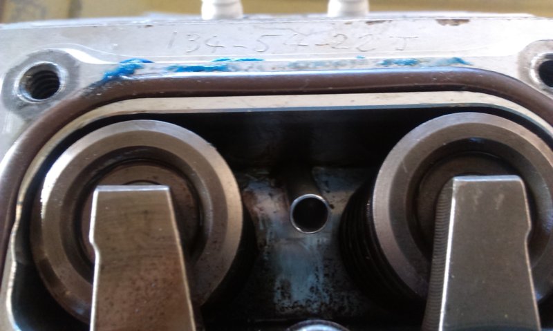

derekliston Posted May 5, 2017 Posted May 5, 2017 I don't know about South Africa, I just don't find them particularly helpful which grieves me because I defend Jabiru engines against all comers! Anyway, since I am not willing to live with the problem having thought about the problem I have come up with a small mod in the form of a short tube fitted with a slight interference fit. I think this should work provided the oil level in the rocker box isn't too high when the engine is running. I am a retired LAME but confess I have no idea of that particular. Does anyone on the forum know the answer to that? I will find out fairly quickly once I run the engine. I will try to upload a couple of pics shortly. 1
derekliston Posted May 5, 2017 Posted May 5, 2017 Couple of photos once I figured how to get them here!
