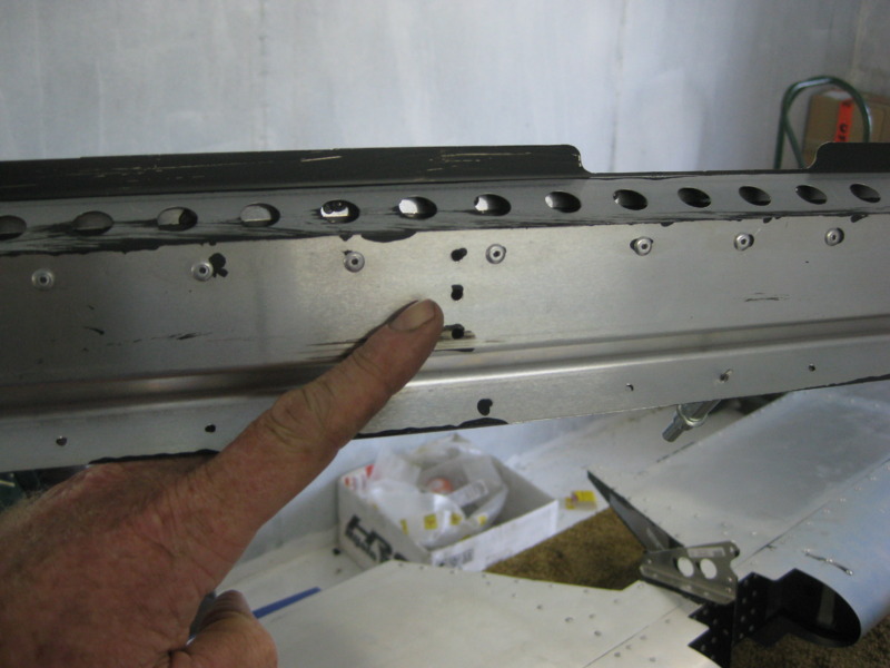

Hadyn Bell Posted June 22, 2012 Posted June 22, 2012 Hi Mark, Attached is a photo (i hope) of the trim tap with the 3 holes in it. Do you recall if these holes are there for the manual trim adjustment and just need to have rivets fitted since we have the electric trim option?? Hope the head cold is sorted and you get some flying in this weekend. Beautiful day here on Norfolk, just thinking if we had the Sav finished, which way I would do my 15 minute cross around the island, to the left or to the right, round and round we go....
Gundy Posted June 22, 2012 Posted June 22, 2012 Hayden they were the old trim tab design just ignore them. U could leave them out of fill them with rivets. Up to you. Gundy
Kyle Communications Posted June 22, 2012 Author Posted June 22, 2012 I think I put rivets in mine but Gundy is right its from the old design....the trim is now driven with the Ray Allen servo mounted at the tip of the tailplane I am up at the farm this weekend...its bloody raining and my internet wireless is crap...must have a faulty modem I think

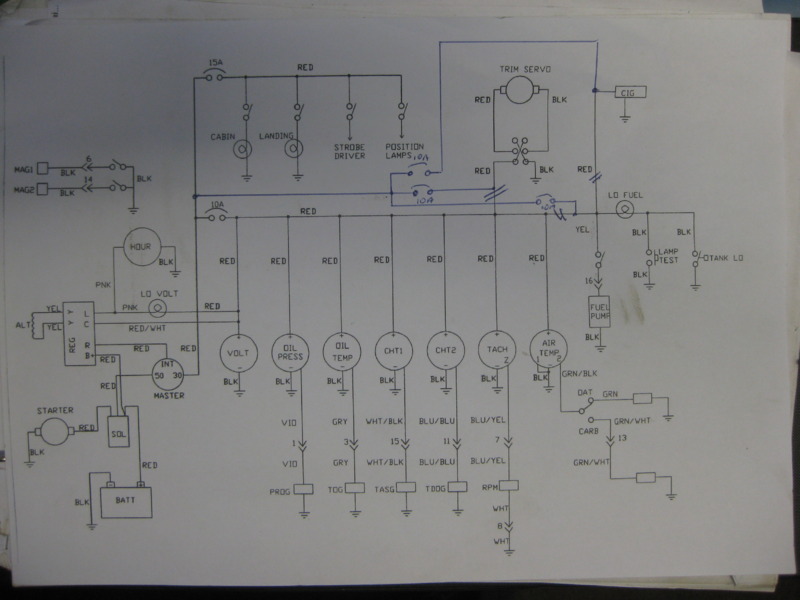

Hadyn Bell Posted June 26, 2012 Posted June 26, 2012 Hi Mark, Best I load this onto your forum, not mine!! Could you please run your nose over the Sav wiring diagram attached for your opinion on the extra fuses that I think are required. We will stick to the original harness and just the extra fuses as much as I liked your harness and fuse box. If you cant read it I can email it to you. Cheers Hadyn

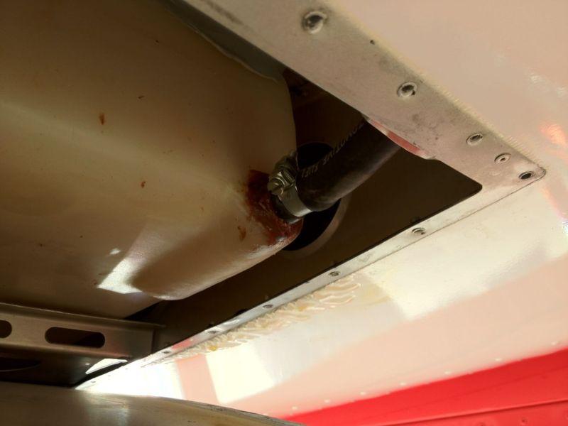

bobcharl Posted July 6, 2012 Posted July 6, 2012 Mark, Re your petrol leak problem,I have just started looking for a petrol resistant sealant for threads and flanges but have not found anything in which I would have a lot of confidence. Seems a petrol resistant washer inside the tank would be better than under the nut which would still leave a pathway along the thread(unless a thread sealing medium is used) A local firm which deals exclusively in petroleum handling equipment and fittings say nothing beats ordinary plumbers teflon tape for a petrol resistant thread sealant, but I am not yet convinced. Does anyone out there know? I feel sorry about the damage your leak has caused your lovely paint job, Mark. Bob
Tex Posted July 6, 2012 Posted July 6, 2012 Stag joining paste or Loctite 505 is supposed to do the job.
Kyle Communications Posted July 6, 2012 Author Posted July 6, 2012 Hi Bob I found the answer its called Pro-Seal its a epoxy used to make fuel tanks etc for aviation... I have got some and will redo all 4 tanks main outlets and the bottom fittings for my sight gauges. I also got some fibre washers which will go on the outside over the fittings between the tank wall and the nut. I will put the proseal on the tank outer wall then the fibre washer then more proseal then tighten the nut up then make a fillet around the nut and tank so its a permanant seal...it wont leak anymore. The other tanks at this stage have not leaked but I have no idea why the nut went up another 3/4 of a thread. Maybe the plastic tanks depress over time not sure but it will be fixed next week. I am up the farm this weekend so have a big day slashing and mowing and whipper snipping and if I get some more time I will finish the welding on my internal lift in the shed...bloody cold and widy up here tonight too so will be brass monkeys here in the morning me thinks Mark
Tex Posted July 6, 2012 Posted July 6, 2012 Just FYI some recent research I did came up that Pro-seal was once no good with Ethanol. Probably not an issue now. If you are just after an epoxy then Vinyl Ester is the go.
Kyle Communications Posted July 6, 2012 Author Posted July 6, 2012 Hi tex All the blurb says it can handle 100LL and jet fuel etc now...the stuff I got is actually used by the airlines for their fuel tank stuff...so they must have fixed the issue although ethanol will eat anything...
Tex Posted July 6, 2012 Posted July 6, 2012 yeah it is a very hard subject to pin down: the whole compatible with fuel thing. No ethanol in Avgas or JetA1 and they are just sealing a a metal tank. Pro seal seems to be targeted at that sought of thing, sealing a metal tank. I think that that tank is Fibre Glass re-enforced Vinyl Ester Resin, but I am not real sure what exactly it is you are doing with it so.... don't mind me.....
Kyle Communications Posted July 6, 2012 Author Posted July 6, 2012 The sav tanks are a blow molded type of plastic not fibreglass or metal. Its a funny sort of stuff. The red/brown stuff I used was supposed to be ok for petrol but it basically crumbled away when I got to the tank fitting. I am hoping that the fibre washer and the epoxy will make sure it doesnt leak anymore. sort of 2 levels of protection
