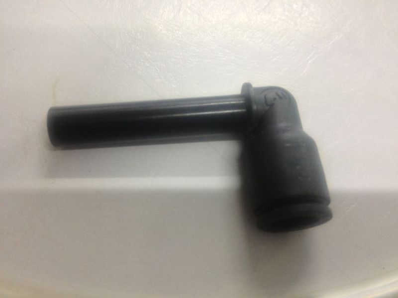

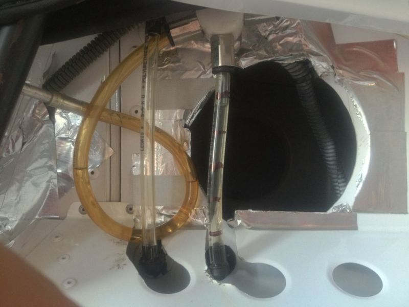

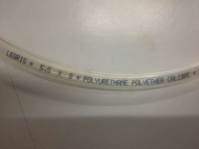

I finally found something to take care of the horrible rislan tubes that are used for the tank sight gauges. The discolour very quickly and are a real pain to change. I have used festo and Legris pneumatic fittings for many years on my jet models with Avtur and they work fine. My fuel feedback and sump tank breather come back to a fitting I made up using these types of fittings you can see the teflon block I made and the Legris fittings into it. They just push onto the 1/4 inch alu pipes I fitted and also what ICP uses this makes it very easy to fit new tube for the sight levels also the tube I am using will eventually discolour but it is a 5 second job to replace it.
The pictures attached will show the fitting which I trim the solid bar section smaller and the tubing in 8mm outside and 6 mm inside so 1/4 inch being 6.25mm it makes a nice hard push on sealed fit to the Legris fitting. I need to put my fuel indicator plates back and cover the holes up again but you should be able to get the idea. On the standard Sav stuff the Rislan connects onto the fittings in the tanks all you need to do is fit some 1/4 inch alu tubing to rubber hose onto the fitting and extend it out to the root rib on the outside then just use the Legris fitting and tube and presto easy to see ...no leaks and very functional. I can supply the part numbers if anyone is interested
I finally found something to take care of the horrible rislan tubes that are used for the tank sight gauges. The discolour very quickly and are a real pain to change. I have used festo and Legris pneumatic fittings for many years on my jet models with Avtur and they work fine. My fuel feedback and sump tank breather come back to a fitting I made up using these types of fittings you can see the teflon block I made and the Legris fittings into it. They just push onto the 1/4 inch alu pipes I fitted and also what ICP uses this makes it very easy to fit new tube for the sight levels also the tube I am using will eventually discolour but it is a 5 second job to replace it.The pictures attached will show the fitting which I trim the solid bar section smaller and the tubing in 8mm outside and 6 mm inside so 1/4 inch being 6.25mm it makes a nice hard push on sealed fit to the Legris fitting. I need to put my fuel indicator plates back and cover the holes up again but you should be able to get the idea. On the standard Sav stuff the Rislan connects onto the fittings in the tanks all you need to do is fit some 1/4 inch alu tubing to rubber hose onto the fitting and extend it out to the root rib on the outside then just use the Legris fitting and tube and presto easy to see ...no leaks and very functional. I can supply the part numbers if anyone is interested
Hi Mark,
As im ready to plump up the tanks, this is something i should look at. I should get you to supply the fittings and pipe along with the prop pitch gauge when you have finished. Sing out when you have it all together...012_thumb_up.gif.cb3bc51429685855e5e23c55d661406e.gif
I had better get to finishing your prop pitch gauge...I have made a few of the bits but haven't got back to it. I can get the legris parts easily they are just down at Brendale you just need to make sure you bring out the sight gauges with 1/4 inch alu tube to the inside of the wing root like I did. Its easy you just use fuel tubing and some worm drive clamps to join them onto the tank fittings. I am sure you will see the pics in this blog on how I did it
