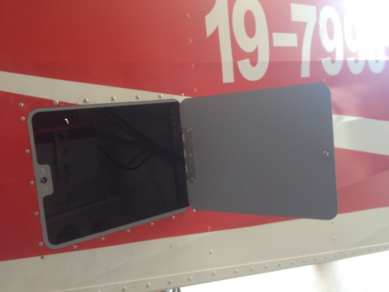

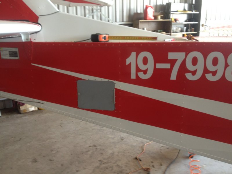

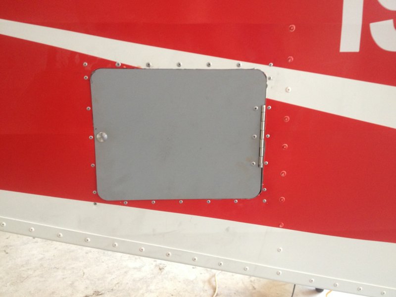

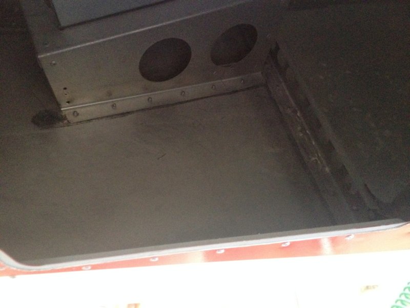

Kyle Communications Posted January 11, 2014 Author Posted January 11, 2014 Finished the cowl off ready for paint yesterday got the heat relief holes in each side of the cowl cut out and the rest of the cam locks done. Today the last job was to install the second battery door on the pax side of the aircraft. This now allows me to fix a plastic box with a locking tab on it so I can store my tie down kit and other gear in there. I have to submit a new weight and balance with all the paperwork including the 600kg mod paperwork and the L2 sign off on the repairs. When I do the W&B I will put progressive 1 litter bottles of water in the back area I can access now and get all the figures so I will know exactly how much weight I can put in the back. The painter is all kitted out now with a key to the hanger so just have to wait for him to finish then I can reinstall the nose wheel and the modified rudder pedals and she will be ready to go…..will be working on the new dash panel now while all that happens Mark 1

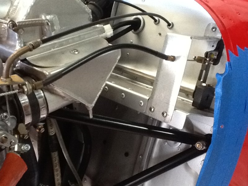

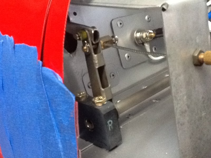

Kyle Communications Posted February 20, 2014 Author Posted February 20, 2014 Not yet but not too far away..The painter has finally done underneath the front floor so now I can put the nose leg back on.... the cowl and spinner has been painted just need the wingtip done now. I am almost finished my new dash but was waiting until the plane gets on all its legs before I fit that. Just need to fit the new prop and set it and then run her up and balance the prop. New springs for the carbs that will at least make her fly again then I will look at changing the throttle cable system like a lot of others have now. 2
Kyle Communications Posted February 23, 2014 Author Posted February 23, 2014 Noseleg is back in the main undercarriage and wheels and brakes are now changed over also the prop is assembled and on but have to set the pitch yet. Just need to put some carpet on the floor and mount my new modified rudder and brake pedals then fill the fluids up on the engine and go for a start. I still have to change over the dash but will leave that until after she is flying again. Still a small amount of painting to be done but basically its almost ready to fly 3
