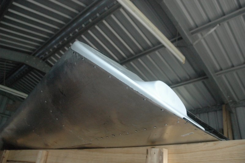

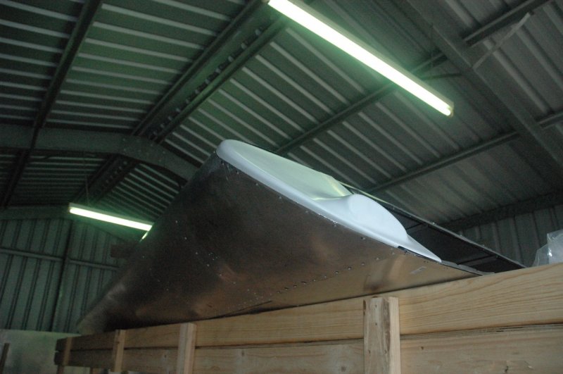

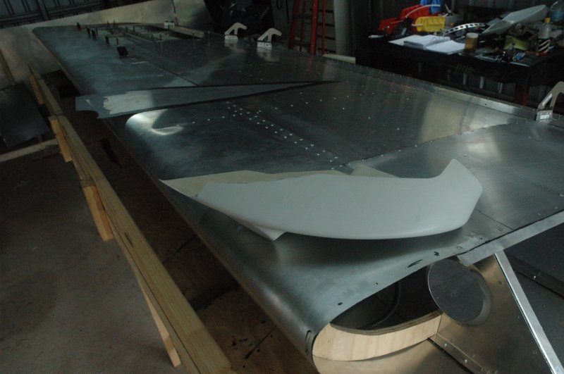

Kyle Communications Posted January 28, 2016 Author Posted January 28, 2016 If you keep the template as close to the edge of the alu its easier. Its still a bit of fiddling but so long as it looks good thats all that matters. Dont forget to take the template out...I nearly sealed up the last wing tip with it in there...luckily I remembered.
Lyndon Posted January 28, 2016 Posted January 28, 2016 Did you trim your glass corner at all. The pics seem to show it cut on the top rear where it fits under skin and angular. Lyndon
Kyle Communications Posted January 28, 2016 Author Posted January 28, 2016 Yes I trimmer the fibreglass tips to fit nicely underneath . The top wing skin tensioner/stringer was the issue I cut it out. I think I have some pictures at home of the cutout I did. I will look later tonight when I get home
Lyndon Posted January 28, 2016 Posted January 28, 2016 Thanks. I shall wait to some better pics. I've got it very close . But it won't hurt to see what you have done. Lyndon
Kyle Communications Posted January 28, 2016 Author Posted January 28, 2016 I found these you can sort of see where I modified the glass tips 1
