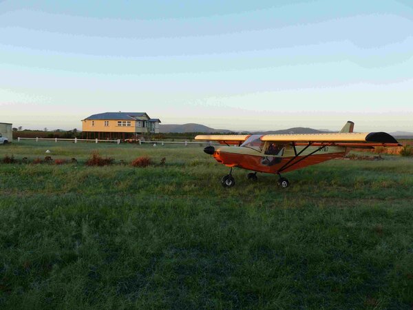

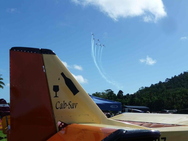

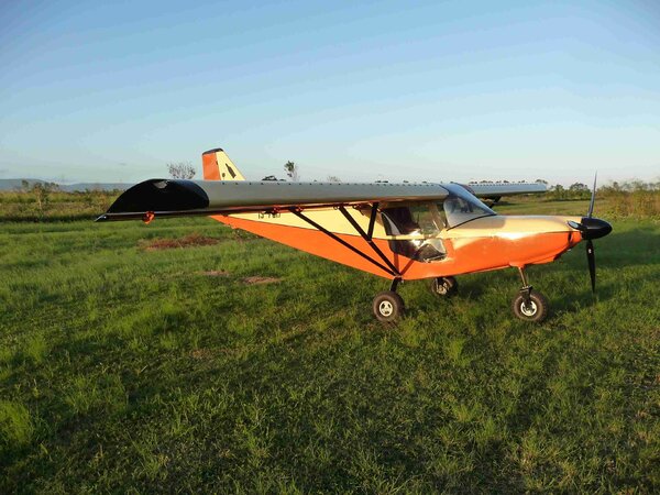

Kyle Communications Posted May 1, 2011 Author Posted May 1, 2011 Hi Ian Pics look great I love the tail motif Great to see it flying. Did you fly her to the show?...are you happy with the performance? Who did the initial flight Maj? Blow by blow description on inital flights and the trip to the airshow would be good Mark
ianwells Posted May 1, 2011 Posted May 1, 2011 Hi Mark I did the first flight on friday afternoon, then a couple of hours on sat after work and flew into the airshow very early sunday morning. So far all is going well, over 5 hours and 25+ landings, nearly got the landings sused now. Very easy to fly but much faster than the drifter!!!! very happy with the whole thing at the moment:cheezy grin:
