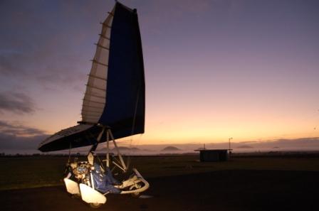

Guest Perry Posted January 11, 2007 Posted January 11, 2007 Kimbo, Check out all 912's and 912S's - Airborne, Pegasus, DTA etc. We migrated from an Airborne Edge to a DTA 912S. Yep they cost heaps more, however, you get what you pay for and the four stroke derivatives offer better reliability, economy and longevity that results in a comparative life-cycle cost. So far our 912S is 127 hours old, it climbs like a demon, carry's a reasonable payload and is excellent for expedition triking. It is presently returning an economy of 9 litres per hour over its life and has had minimal maintenance requirements in comparison to my 582 two stroke. We chose ours for rugged undercarraige and capability. In DTA France I have seen farmers using the Voyageur 912S for crop spraying activities! For our use, we will not easily go back to two strokes. Picture attached for envy... Regards

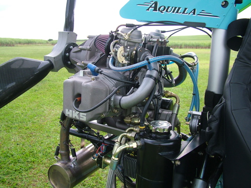

ZULU1 Posted January 25, 2007 Posted January 25, 2007 Two strokes Sir, If you have a large hangar door the 582 performs well as a door stop..I have flown most engines in trikes. As previous threads will tell you the 912 has 1500 hrs TBO, the 582 will require crank replacement after 350-400 hrs. The fuel consumption is probably double, sure they do have nice performance. But if you live at low altitude fly a lot on your own; other less expensive options exist with 4 strokes as well..Take a look at the HKS 700e (60 hp), Verner boxer twin (80 hp) and Verner radials. Maybe the Jabiru is an option also.. For info my first 582 popped at 190 hrs and the second one at 380 hrs, that was enough for me. I couldnt justify the 912 as we use the trike as a test bed for avionics so it gets a lot of short trips. Fuel consumption and reliability was the main choice. I installed the HKS 700 e it gives me solo 900 fpm and dual 600fpm with fuel burn solo 6 litres an hour dual 9,5 ltrs maximum. At 200 hrs now just changed the plugs, starts first time, no problems at all. BUT it has oil in it !! The 503 incidentally is not a bad option, they seem to last longer..still two stroke. Here in South Africa we have lost a few people with 2 strokes, the tendency in Johannesburg is to use the 582 as its 6,000 feet, two strokes definitely lose less power with altitude. Hope this helps a bit. Cheers Paul
ZULU1 Posted January 25, 2007 Posted January 25, 2007 HKS 700e See pic of the HKS fitted to Aquilla as an option.
Guest Crezzi Posted January 25, 2007 Posted January 25, 2007 I've only flown the HKS in a Pegasus Quantum but have to say the performance difference dual (compared to 582) was more than I expected from the bhp figures. The Jabiru is interesting idea - I know of 1 trike manufacturer who spent a long time trying to get it to work properly & never suceeded. Eventually it was abandoned in favour of 912. Somebody know of any trike with the Jab as an option ? Cheers John Cheers John
