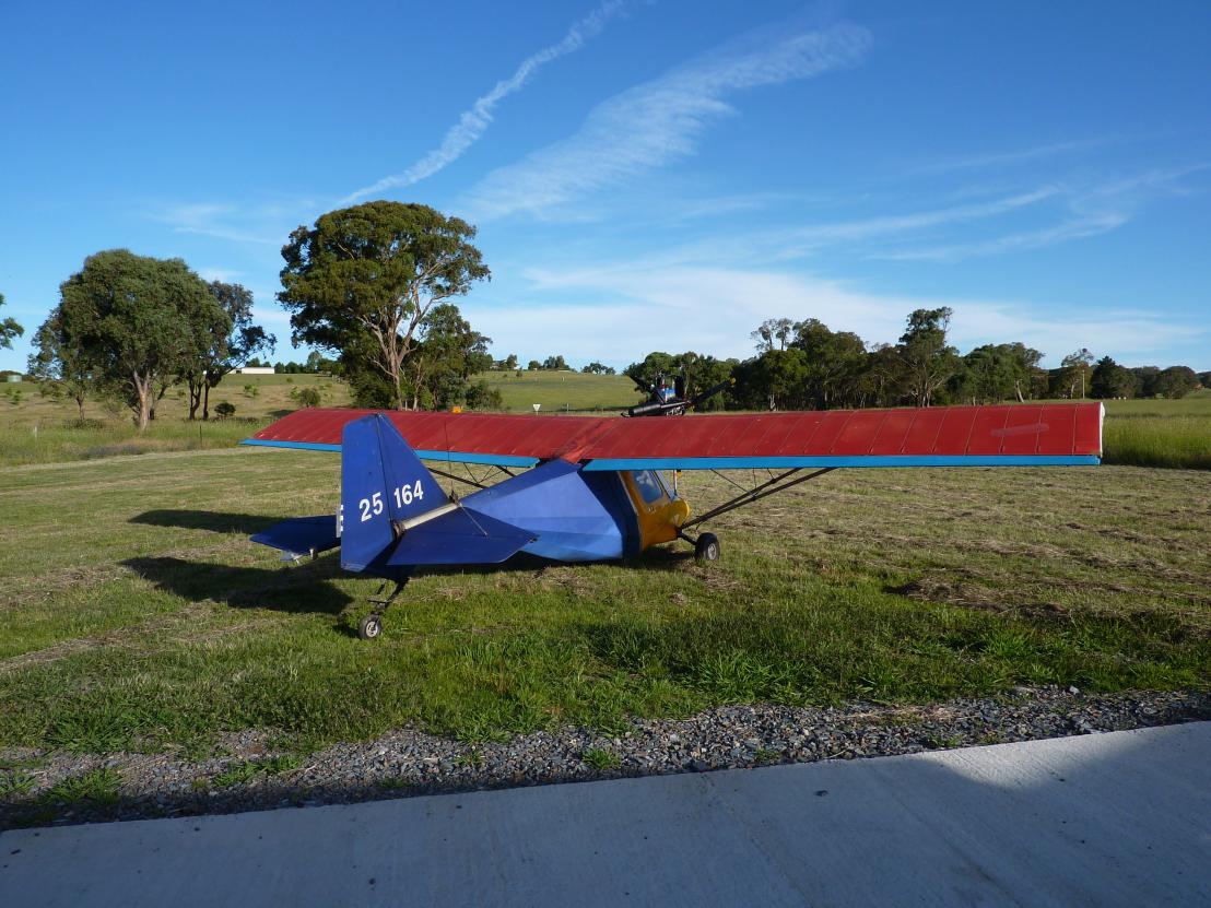

Guest striker Posted December 13, 2010 Posted December 13, 2010 [ATTACH]12671.vB[/ATTACH] Here's how my thruster sits with the new springs Pud. I'm told the wheels should be vertical when loaded with fuel and people. I'm happy with the ride and having a home strip/ paddock it's good to have the heavy duty setup and yes it does sit lower. The spring diagram is in the Tony Hayes T500 manual, which has a lot of other useful information in too. Pulled the thruster out for a flight yesterday afternoon. Magic. Cheers.......Phil [ATTACH]12672.vB[/ATTACH] [ATTACH]12673.vB[/ATTACH]
pudestcon Posted December 14, 2010 Posted December 14, 2010 [ATTACH=CONFIG]19775[/ATTACH]Here's how my thruster sits with the new springs Pud. I'm told the wheels should be vertical when loaded with fuel and people. I'm happy with the ride and having a home strip/ paddock it's good to have the heavy duty setup and yes it does sit lower. The spring diagram is in the Tony Hayes T500 manual, which has a lot of other useful information in too. Pulled the thruster out for a flight yesterday afternoon. Magic. Cheers.......Phil [ATTACH=CONFIG]19776[/ATTACH] [ATTACH=CONFIG]19777[/ATTACH] Thanks striker, Nice looking machine you have there. My wheels are 'toe out' already without wings, fuel or me!!! on board yet. Might have to revisit the undercarriage configuration before the test flight. Glad to hear you went for a fly, I'm rather envious. Cheers, Pud
