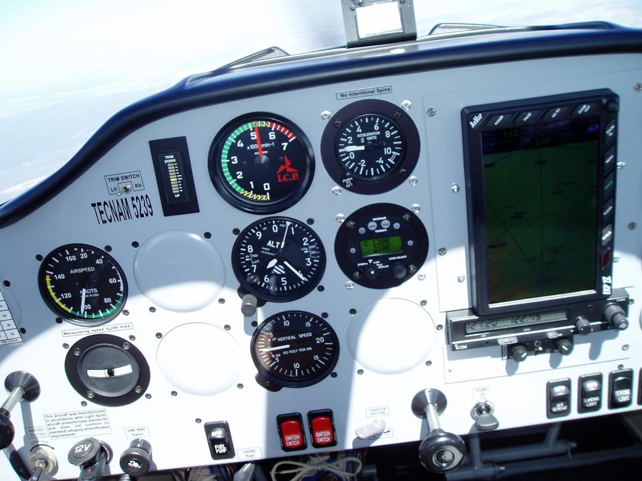

Guest Cloudsuck Posted May 9, 2010 Posted May 9, 2010 After owning an aerobatic plane fitted with a G-Meter, I now always have one in my aircraft. I fitted one to my Tecnam when it was new and have never pulled more than 3G but regularly pull 2G in steep turns, dives etc. Unless you are doing aeros all the time, pulling 4G will never go unnoticed by the average punter. As Mazda said, if you are pulling 4G, you are being naughty or in trouble. I used to pull to 4G when doing loops in the Yak. And yes, rolling G is the one to be real careful of. It has been my experience that pilots who have never pulled G always think that they are pulling 4 when they are actually only pulling 2. I am a bit of a G pansy and 4G is plenty enough for me. I have felt 5G in an L39 Albatross and it was not comfortable. I saw a mate do a routine in a YAK-50 one day and when he landed, the G-Meter was pegged at 9G.
Tomo Posted May 9, 2010 Author Posted May 9, 2010 Cloudsuck: what type are you using? is it portable or relies on aircraft power source - ie mounted in the instrument panel? Also when I said 4g, I was just making a point, I'm sure I would never get there! But it is true how you get more and more used to something so to make it still feel the same, you often get further into it. Copy the fact that you shouldn't rely on anything other than your training a lot of the time. And a G meter isn't going to save you, but it'd be pretty interesting how much you do pull on some occasions.
Guest Cloudsuck Posted May 9, 2010 Posted May 9, 2010 Quote Cloudsuck: what type are you using? is it portable or relies on aircraft power source - ie mounted in the instrument panel?Also when I said 4g, I was just making a point, I'm sure I would never get there! But it is true how you get more and more used to something so to make it still feel the same, you often get further into it. Copy the fact that you shouldn't rely on anything other than your training a lot of the time. And a G meter isn't going to save you, but it'd be pretty interesting how much you do pull on some occasions. Tomo, this is a good thread you have put up. And you are right, pilots can get G-Fit. The one I'm using is not powered and is simply a mechanical unit (Photo attached). I prefer this over the electric ones. I have a mate with an electric one in his Savannah and he is surprised at how he never gets over 1G:laugh: I think a G-meter is a pretty simple and good addition to any aircraft. If you have ne ver used one, you will be surprised that how, in really head banging turbulence when you think the wings are going to come off, you are only hitting 1.5G. There is a G-Meter app for the iPhone. It seems to work correctly.
