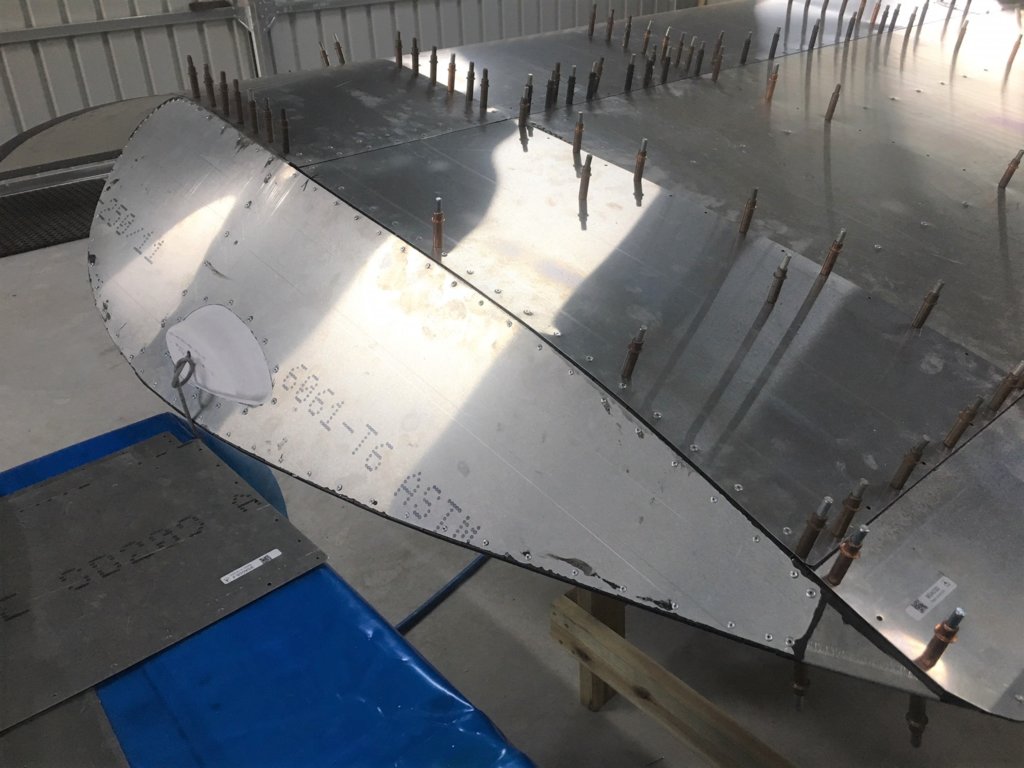

  2. Our thanks to both you fellas, and the message is, 'do the job once, and do it right'. But also keep an eye on anything that is likely to fall out or fail. Will meet up with Mark Kyle this Friday and another good bloke Chris who is building a Savannah at Caboolture also. For your interest and 'riveting' stuff, is ends of R/H wing with 'close up' hopefully in the next day or two with the nose skin happening also. Cheers Frank

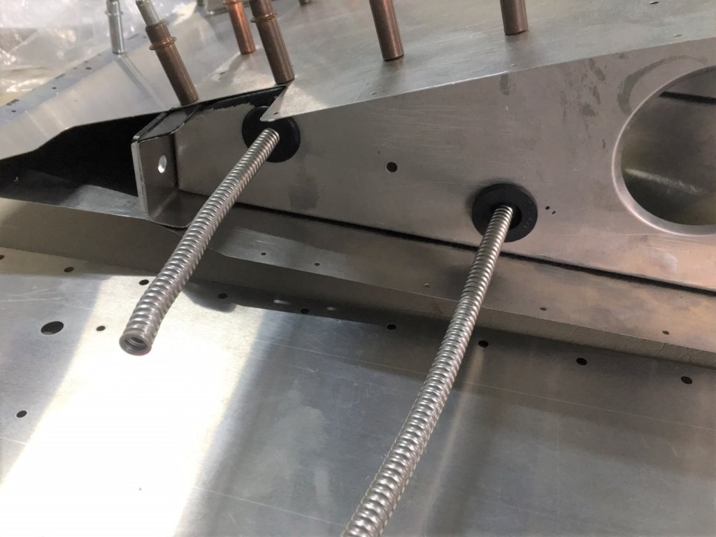

  3. Excellent stuff Mark, thank you. I will attempt to source your build blog and study it. The fuel system is now becoming very clear thanks to Ibob and yourself. As mentioned earlier in the day I have now modified the original shared pipe, separating the inboard and outboard tanks and ran separate lines to rib #1. Once there it will give me the opportunity to close up the R/H wing and march on. A return tube to the top of the R/H tank is in situ & similar to your system. Your generous offer for a visit is accepted and will give you a call for a suitable time. Frank

  5. Thanks spacesailor for your comments, will keep an eye on the pull rivets we are using. Ibob, your input is what the Doctor is searching for, thank you. The plumbing should be done NOW prior to closing and the separation of fuel supply accommodated. A Savannah located at Dalby is plumbed as you suggest but the respective valves are a tad complicated. If Mark Kyle or Fallowdeer would provide more info I would be extremely appreciative. Cheers Frank
