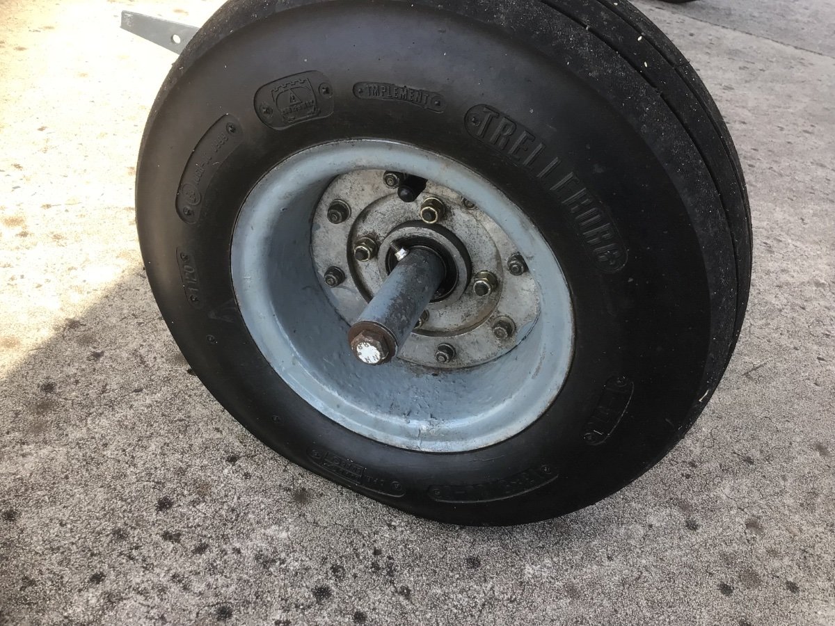

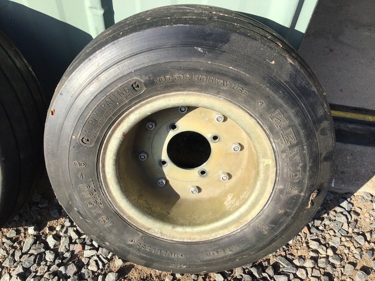

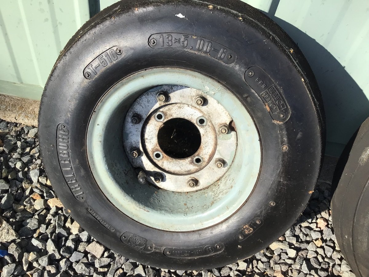

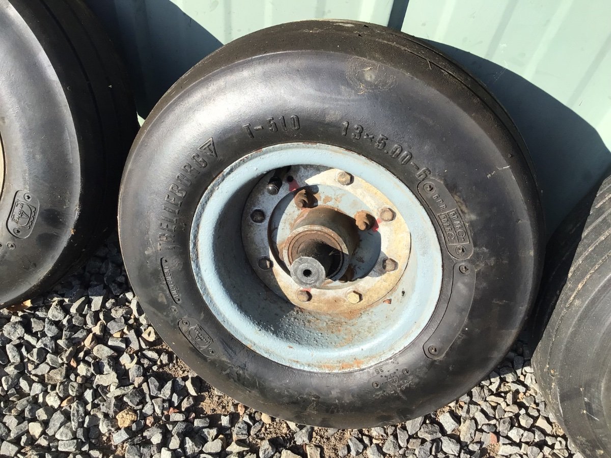

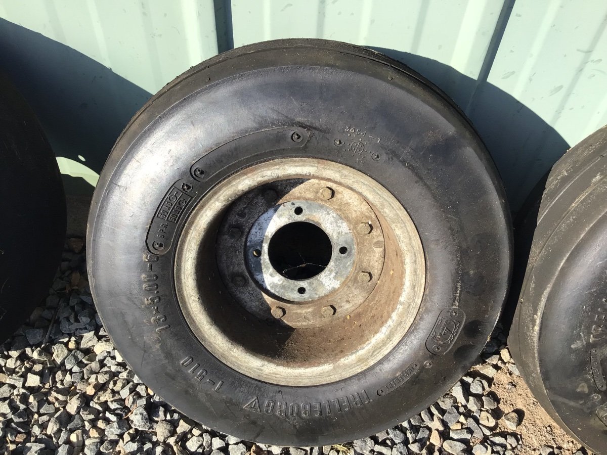

SAJ, I’ve got 4 rims. Steel split rims with nuts and bolts and reinforcing plates for 3 of them. Other one is missing inside bolts. Three of them are fitted with Trelleburg tyres (one still new) . Still all got tubes in them which must be good as they’ve stayed up for a couple of years. Last one has Kenda tyre in very good condition. All tyre sizes are 13x5 x 6. is that the right size for yours? Someone said you need small wheels? Anyway, give me a call on 0400004011 if interested. cheers, Jenny

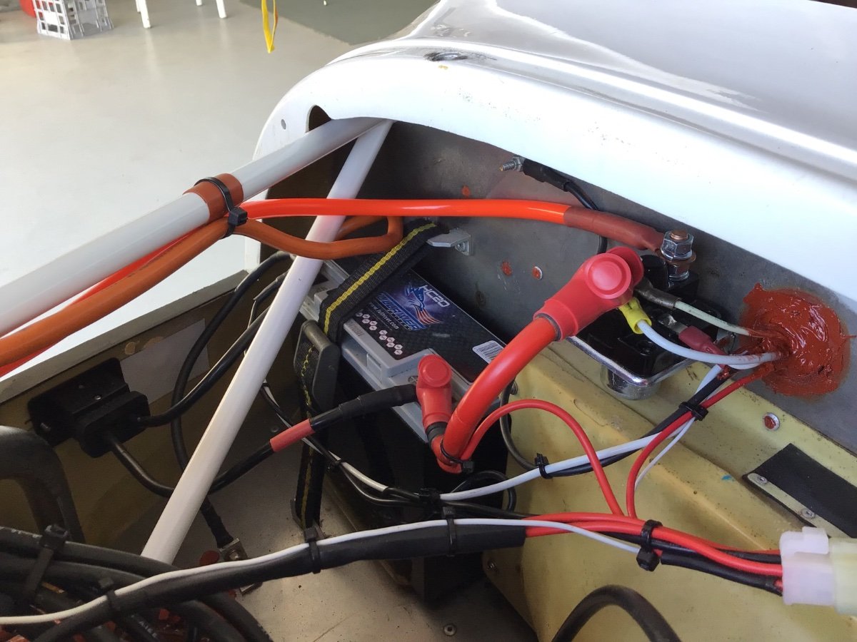

This is photo taken a few weeks ago, doesn’t show the regulator. Note there is no yellow wire going to the battery. Is the thing on the firewall the main bus? Is that where the isolator should go? The red power wire from the regulator is where I’m guessing the 20 amp fuse should go. Does it matter where along the wire it needs to go? Ie close to battery, or close or regulator? Does it matter? -

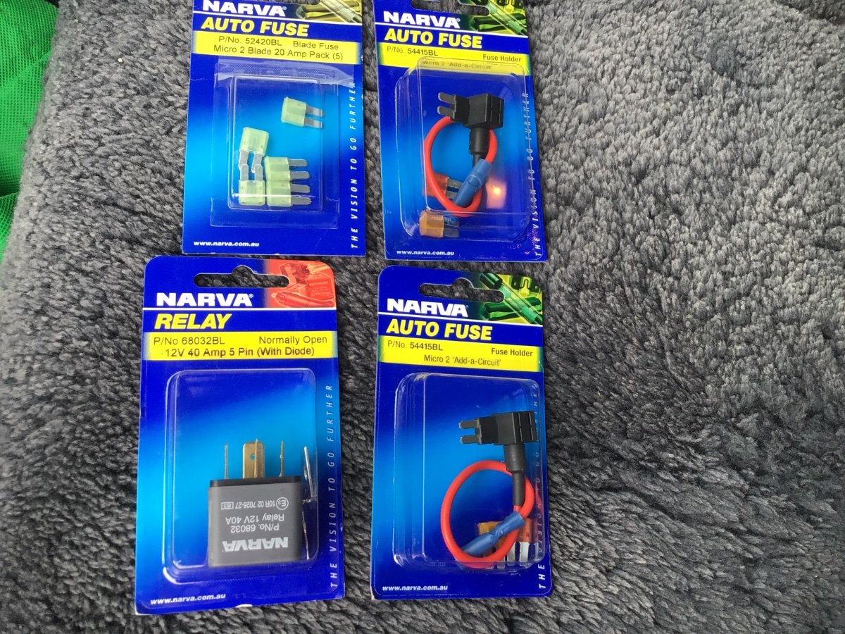

Ok, so I’ve got the fuses and relay. I could only get 5 amp blade fuse, not 1 amp. Tomorrow Shane and I will do the following: 1 put the yellow wire from the regulator direct to positive on battery 2 ensure the earth wire is connected to engine block or the negative on the battery. We still need to determine where the 20amp fuse needs to go and the isolator. I have some wiring diagrams downloaded that may help. We will get these first two parts done anyway, and ask around the gliding people and see if anyone can help during the week! Hopefully this is where most of the interference has been coming from. Thanks again
