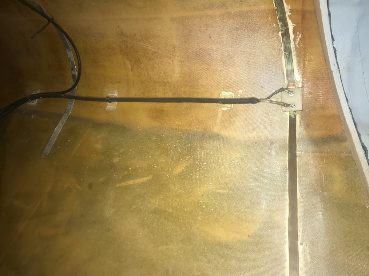

  4. Hey thanks for confirming this. I have a small approx 150mm long skinny stub aerial on top so as Glen mentioned most likely UHF. I'll be reconnecting the broken coax with BNC connectors. That should work OK do you think? I'll find someone to check the SWR before use. Anything else I need to consider?

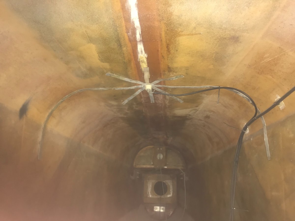

  5. underneath top stub antenna Dipole with copper legs
  6. I have a Pelican PL which has a composite body with aluminium wings. I'm halfway through repairing damage to the bottom of the fuselage. I won't go into how it was damaged at this point but as well as damaged fibreglass it has cut both the coax cables to each antenna. I have both the normal VHF comms radio and also a UHF unit fitted. Both were fitted by the previous owner. There is a dipole type and also a stub type at the top with it's ground plane attached underneath inside the plane. I don't know which radio was connected to which antenna. Does it matter? Should I just ditch the UHF?
