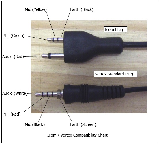

The best option is to buy a small enclosure, a 2,5mm stereo socket and a 3,5 mm mono jack socket, mount them at a pitch of 10mm centres and cut the sockets off that came with the C96 cable in the radio box. Put a small grommet to allow the twin CT 96 cut off and then wire as per the picture. Then plug the old Icom plug into the adapter box. The CT91 from vertex, I havent found to work. Hope it helps. Paul

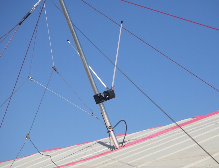

Vee Rabbit Kev, I have absolutely no idea how to adjust an Xcom !! I have never even seen one before but Perrys trying to find one, so we can establish how to do this. As regards the Vee Rabbit, they are a simple fitment with 4 cap screws and a small spanner and Allen key is provided with each kit. The cable is in two pieces and disconnect below the wing attachment. Ian will have some available for viewing at the Natfly stand. Take a look at the pic on a UK Gemini. This bracket is designed for the smaller King Post. Sorry a VXA220 is a Vertex Standard radio and rate them as the best used so far, also from Clear Prop, they like to be fed with 9,6 volts input which Clear Prop stocks the regulators also.. Cheers Paul
Antenna Hiya Kev Just read your thread, I really have no experience at all with the Xcom as Perry advises on his previous thread. However after reading the instruction manual they have a transmit output of 6 watts. This for a trike is hectic and can lead to all kinds of problems with rf ingress when transmitting. This is compounded by a poorly grounded/installed antenna. For our Microair fix which I must confess is really, really good and the best I have seen in a panel mount. When testing in a trike I was asked to identify aircraft type !!! We turn the power down to 1,5 watts, readjust the mic gain as the chatterbox has its own mic amplifier, install a line choke filter (which we specifically designed for a clapped out 503 single ignition) and our Vee rabbit antenna. This was designed for the Airborne / Microair installation at Perrys request. I am not really an antenna boffin and asked our local radio hams to help..That was a year ago and over 300 sales later they are very popular in South Africa, Australia and now selling in the UK, all Quiks imported to South Africa get them fitted standard. The expense for results obtained are worth the effort. But suggest that you try the filter box first..then turn down the power. Maximum of 2 watts output. This will help the tx out. But i have never seen a radio so I have no idea how to do the adjustments ?? The Vee rabbit aids reception and prevents rf ingress from a GPS, Skydat and so on. You can expect transmissions in excess of 200kms easily with a Microair at 1,5 watts and more with a VXA220. So would imagine the Xcom to do the same ? Ian will be able to help you out with all products from Clear Prop. Cheers Paul (Air Magic)

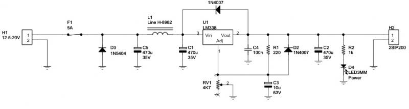

Power supply for ICA6/24 Geoffrey, I think I mentioned it on the forum before but anyway, to make matters worse the ICA6/24 series requires a 11volt supply to power direct from a plane (or car). They will receive but not transmit if over 11,4 volts. The new ICA14 is the same. Minimum power required is 1,6 amps for stable transmissions. Use a minimum of a LM350 regulator as a LM317 dies at 1,5 amps. Not a bad thing as the previous ICA5 and also the ICA3 would destroy itself if surged on over voltage. Also ensure the ANL is on, and if possible install a line choke. Most chaps use a seperate battery which is first prize. The Vertex (all models) works up to 15 volts and is ideal at 9,6 volts as this gives a nice differential on a regulator such as a LM317/338/350 series from 13,8 volts which helps remove the line noise. The Tx is about 0,9 amps at 1,5watts. Google the regulator types for more info, stay with a TO220 package and small heat sink as they are not 100% duty cycle. Parts are really cheap. Attach jpeg of circuit diagram for you. Line choke from a speed and sound shop. Safe flying Paul
