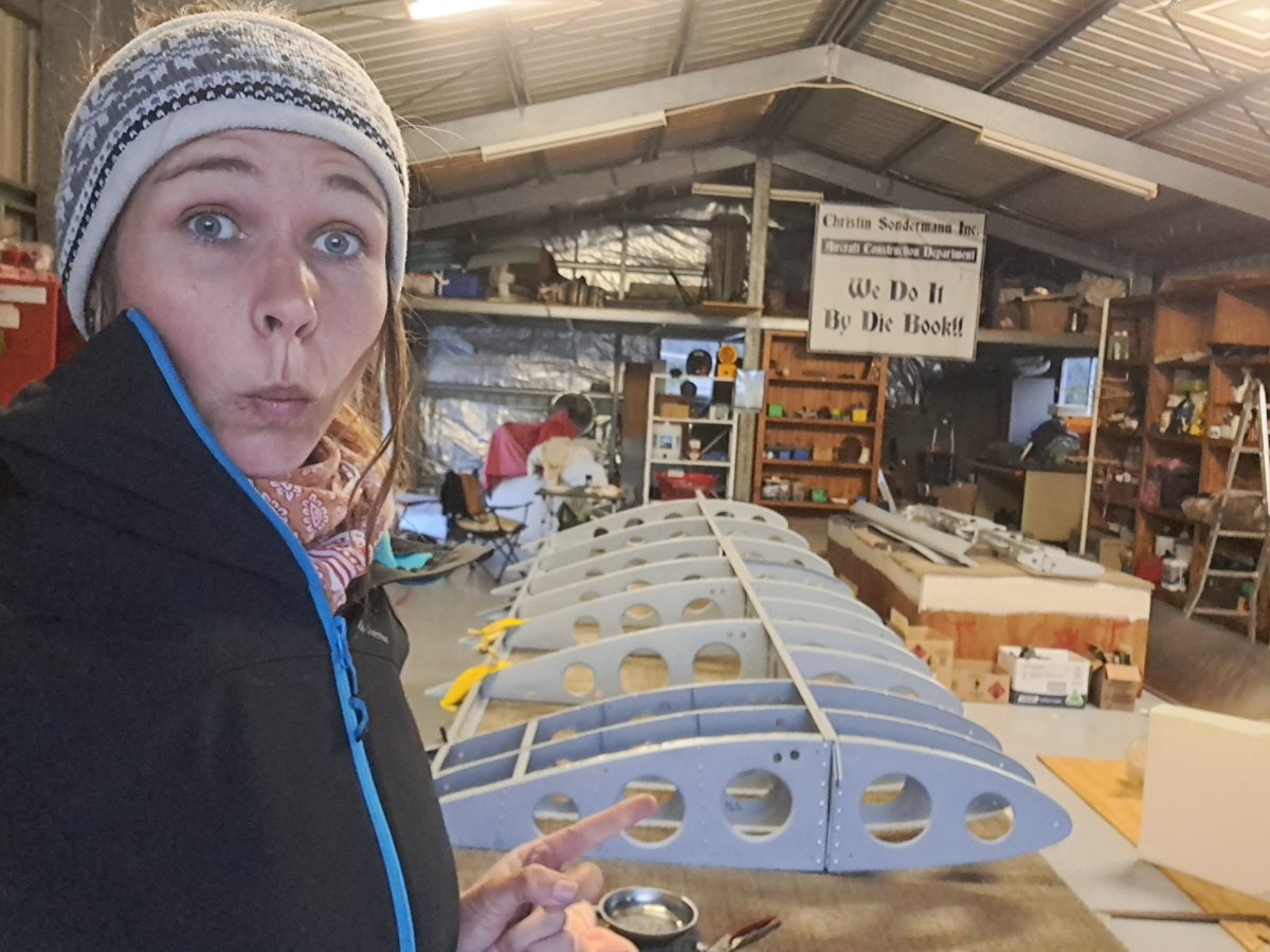

  3. Feel free to call me for any questions. Left wing ready to get some fuel tanks in ✌️
  4. I bought some steel nuts at bunnings. Smallest size. That works with riveting in tight spots so far. I'm epoxy priming everything now, so antislavery not using black stuff. It is a lot of work, but I don't have to worry about paint buddies 😁 Only spray guns. Heads up Bruce, there are more surprises in the manual. Fuel tank installation is "fun". Wings will hopefully be done in the next few weeks.

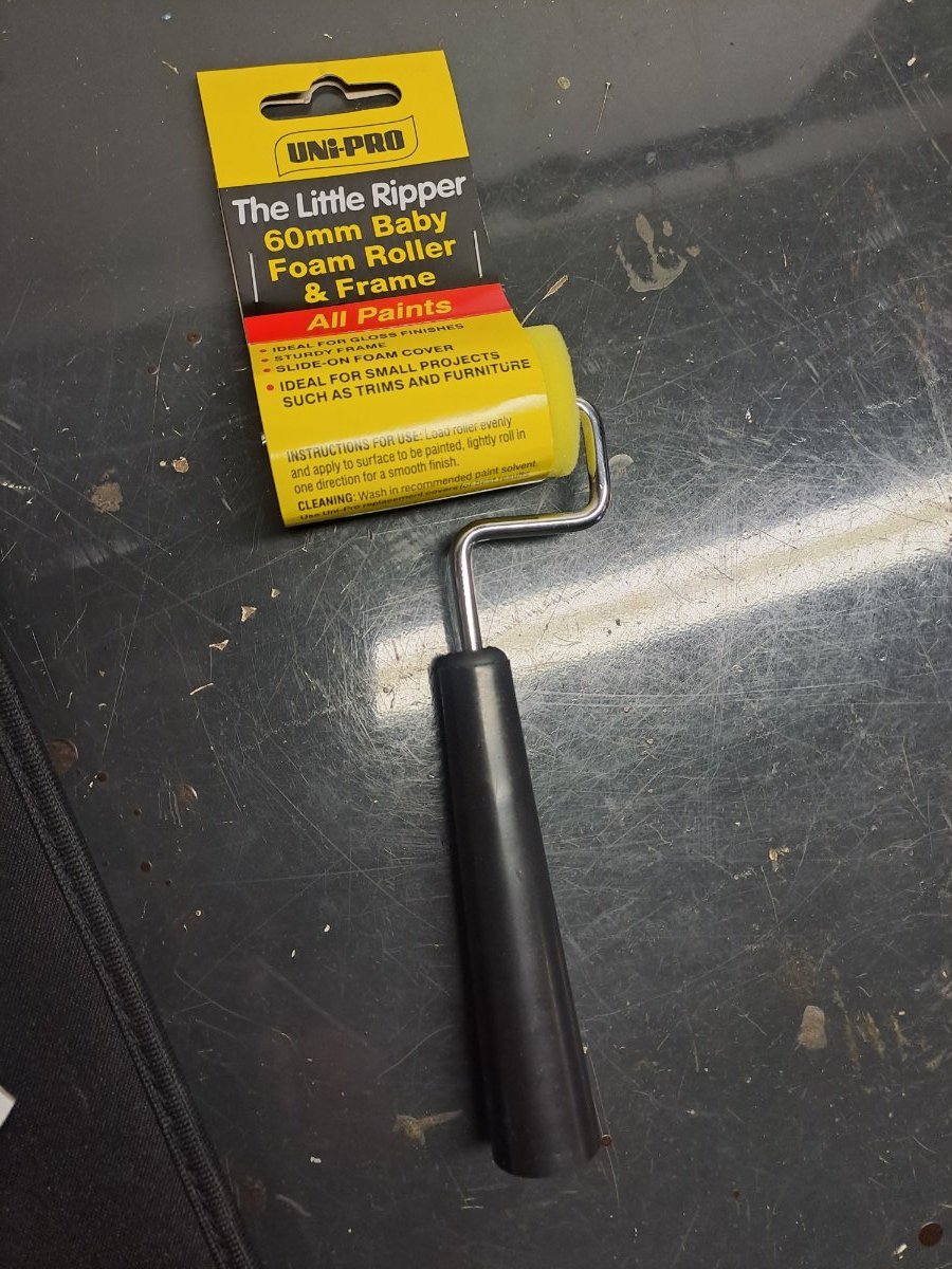

  11. Something like this?

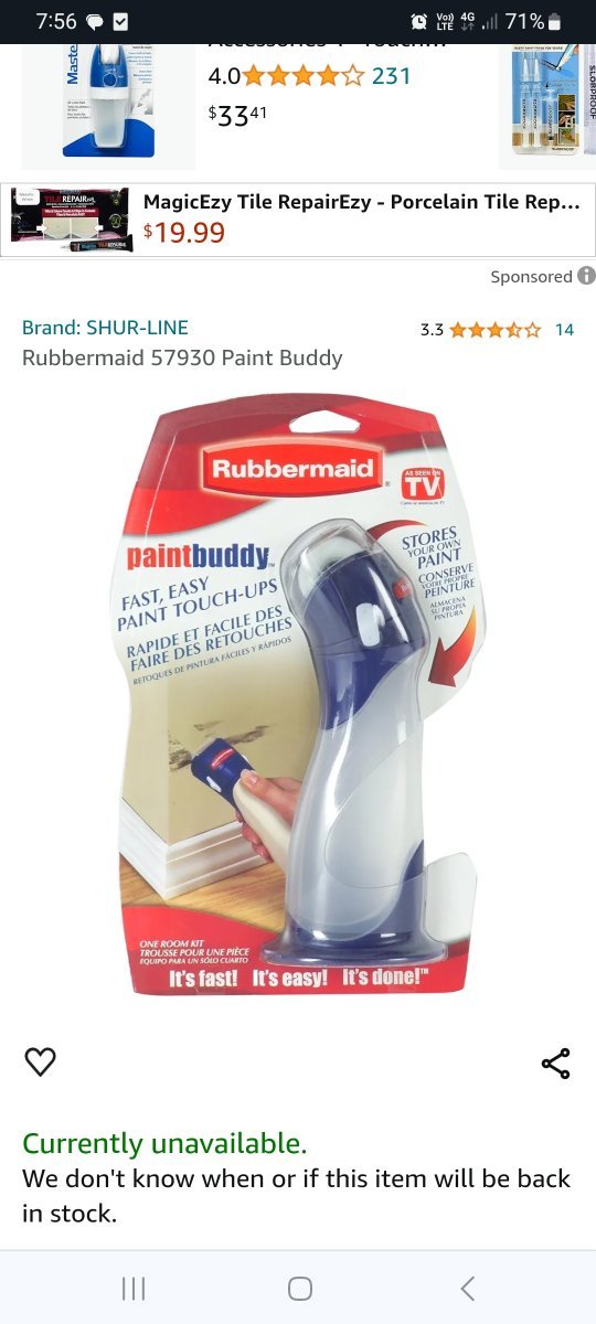

  12. Something like that?
  13. How do I ping Mark? 🙂
  14. I must have missed the parts with the rollers. Do you just use normal paint rollers? That was my plan...
