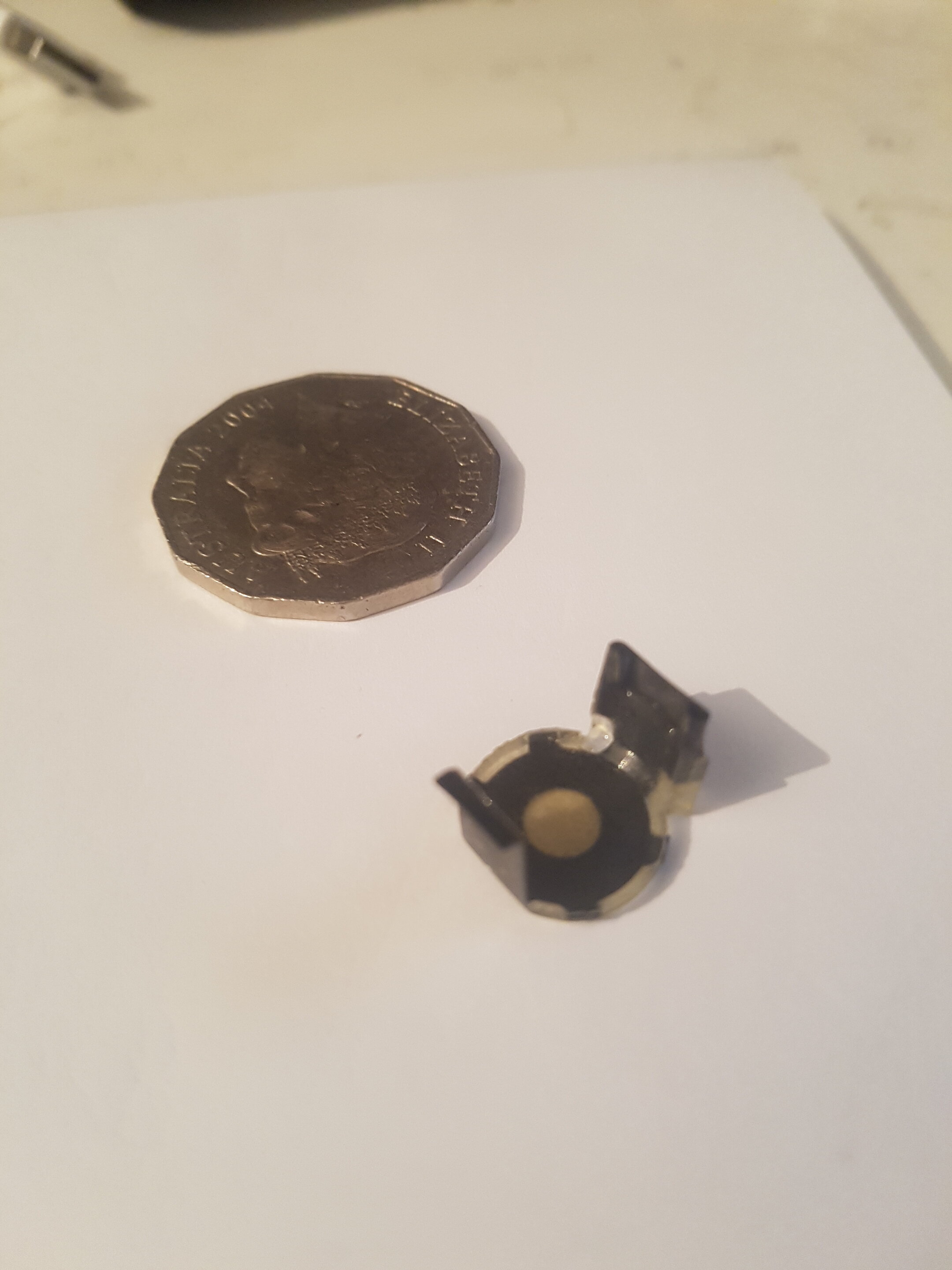

Well three months later and none the wiser as to what the object I found under my plane was, I had all but given up and was trying my hardest to convince myself that it wasn't from the plane. Quite by accident today I identified the object. Its a clip that fits inside the distributor rotor. Moral of the story (well one of them) if you pry off the rotor of your Jab 2200 (which should have been glued to the shaft) make sure the clip comes off with the rotor. Dave

Thanks everyone for your input. No the aeroplane is not in a hangar with other aerplanes its in my driveway outside my workshop. It could well be a part from something out of the workshop. I have been working on the electrics ie; distributors, coils, spark plug leads etc so wanted to be reassured that it wasnt something from any of them. An instructor of mine told me the story of him getting in a cub one day and finding a washer on the floor. The pilot said, "ah it doesn't look important, ignore it", so they did until at 3,000 feet enroute, the rudder cable disconnected from the pedals. They had a very interesting landing some of which was on an airstrip. Hence my paranoia.
I was going to put in my original query. The clip NOT THE 50 CENTS.
I found this on the ground under my plane while working on the engine (2200 Jab). Does anyone know what it is or where it might have come from. Its a worry!!!
