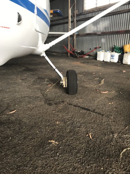

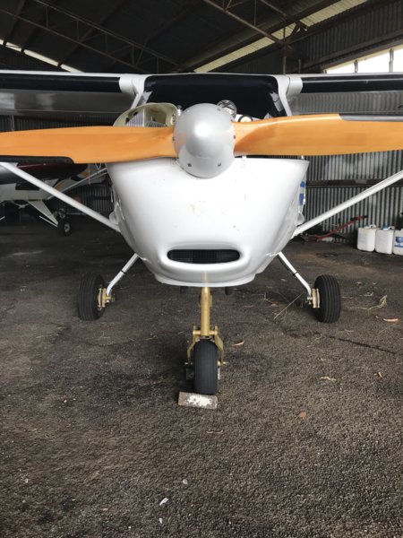

Bruce, here’s a shot from this morning where you will see a difference in the camber, although it’s prob not ideal even now, though works just fine. The legs just lose their stiffness it seems and sag a little. The indicator in last nights photo is when you look and imagine what kind of shimming would be required to get things right which is how I realised there was too much curve / sag in the middle section of the legs. I wouldn’t look at trying to fix them when the replacement cost was pretty reasonable for something with 180 layers of glass in them. It sounds like you might be following in my footsteps - my originals were new in around 2002. Here’s the new pics. PM me if you like - happy to duck you my number and have a yarn

Bruce - I was amazed at the tyre wear I saw between a couple of photos of mine when I realised how little time was between when they were taken them. Anyhow, my Jab took off and landed ok, but I just didn't seem as I would have expected and used to wander a little unexpectedly and at times deliver some interesting 'sideways' type behaviours too. It seemed like the legs were fighting each other a little at times. Anyhow, Jab advised that the older straight gear legs do let go over time, although they hadn't see an actual failure. The crux was when I looked at the camber opposite to what it should have been and realised that correction with shims etc would be absolutely impossible, as the legs themselves had too much curve in them. That when common sense told me the legs had gone floppy!!! Replacement legs were around $600, upgraded to the bigger gear bolts while I was at it. Very straightforward job and totally transformed the takeoffs and landings - dead straight and that was without a wheel alignment or camber adjustment. Totally different!!! Here's the before shot when you can see the incorrect camber- I can take a snap of the 'after' if you need it...just cant find one atm...
The manual states a smidge of toe is is recommended. Is it tracking straight and true? I only ask as I had ridiculously accelerated tyre wear, but also some interesting behaviours on roll out etc. which turned out to be worn gear legs. New ones transformed it and not with any great attention to alignment.

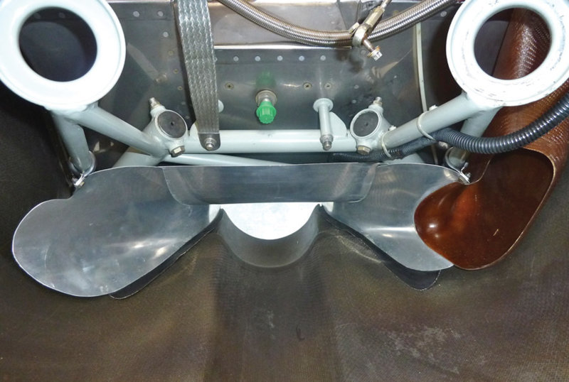

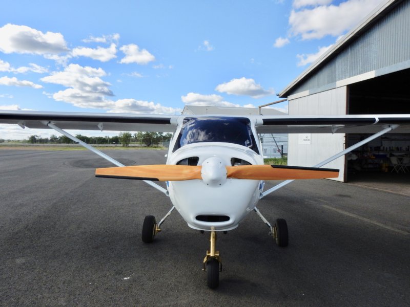

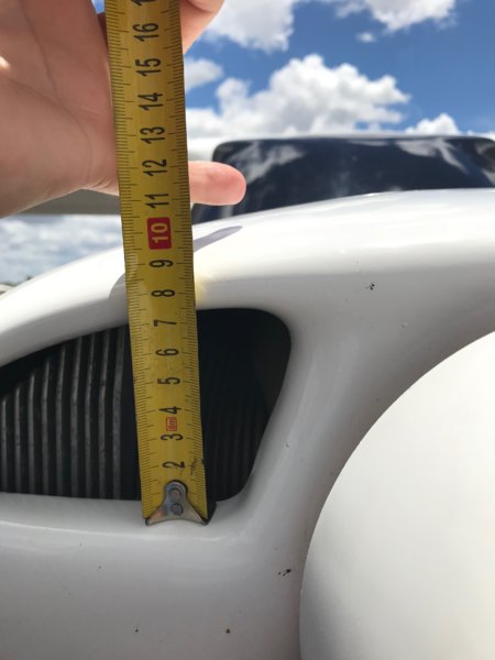

Thanks for checking Ken, as I must admit, that video would be the most interesting thing yet, given I have actually been checking for smoke machines to try just that very experiement!! Nonetheless, the lower cowl shots seem to be quite similar to what I have been seeing on the lower cowl of whats now seems quite a famous RV4 of american airflow 'guru' Dave Anders. He had curved bits on his firewall to 'arrange' the flow outwards, like yours. (I'll see if I can find the shot of his...) Two things I have been wondering about yours (yes, I actually have been...) 1. I don't suppose it's ever best tested without the balance hose between the ducts? (I have been infinitely curious as to whether that would help...) 2. How the intakes on yours compare to mine, as many have opened theirs up quite a bit from the older style top cowl like ours. Yours seems a hybrid of sorts, but bloody hell, it obviously works!!!! If you ever happen to be walking past yours with the tape measure.....I am still debating whether to open the top or open the bottom more, although I am very much thinking I need to change my lower cowl to this 'overlap' style I spied on a J120 at the factory.
