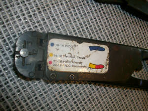

  23. [ATTACH]10941.vB[/ATTACH]59250 AMP Crimp Tool T-Head controlled cycle ratchet crimp tool designed for size 22-14 Tyco (AMP) PIDG and Plasti-Grip insulated terminals and splices. I bought a second hand set a couple of years ago for $120.00 on ebay.These are what we use on commerical aircraft Cheers

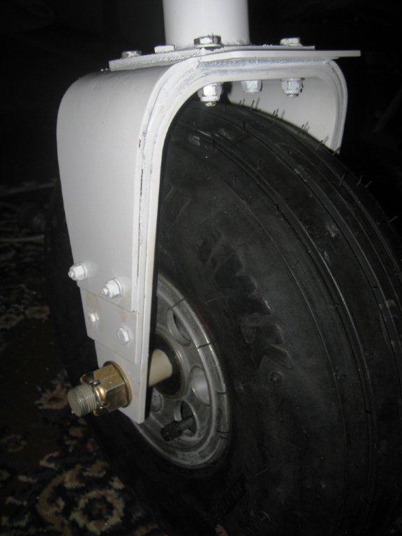

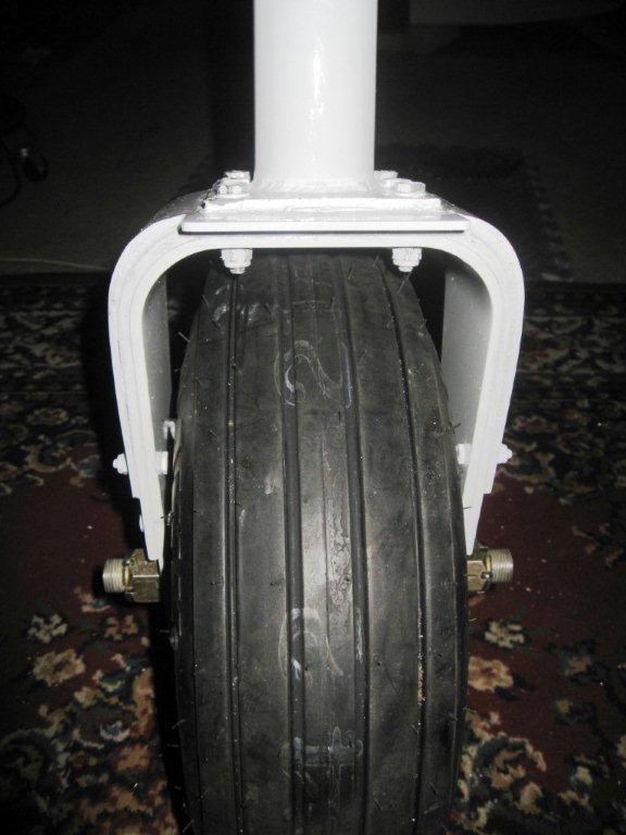

  24. [ATTACH]10598.vB[/ATTACH] [ATTACH]10599.vB[/ATTACH] Beefed up 601xl nose wheel fork made from 1/8" 4130 plate and bonded with tank sealant for good measure Cheers T87
