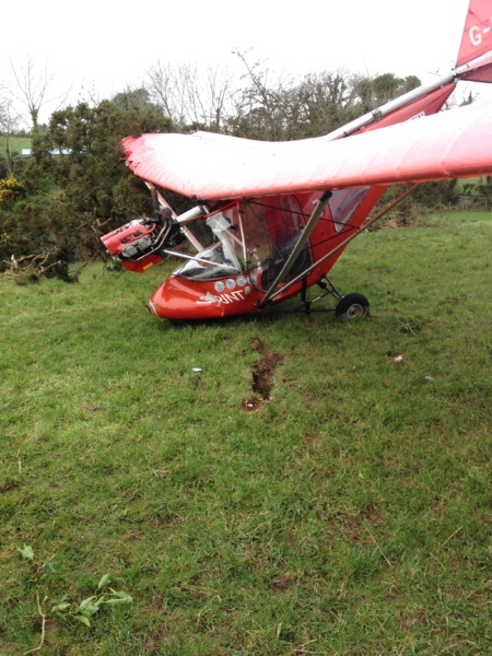

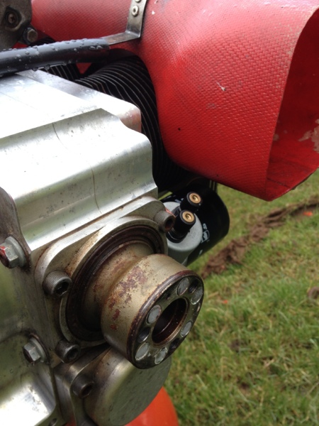

  7. The LAME who inspected it just diagnosed bolt failure, seizure was not mentioned so I presumed it had been ruled out. it will be a few weeks before I talk with him again, and should it be an issue I can update. Meanwhile I expect that some thruster drivers will be looking hard at their bolts..
  8. T600 I think . Not completely up to speed on all the details, but I believe that Jab UK mandated replacement of bolts every 500 hrs following the first event 2 years ago. GKYLE had the specified bolts changed, and the failed bolts were way short of 500 hours. I dont know what prop was involved, except that it was 2 bladed composite. Both events I understand were similar, no warning sudden departure of complete prop. Neither prop retrieved incidentally !

  11. Last week I helped a friend retrieve his thruster from a field. Prop separated at 2300 rpm as he was climbing to join the circuit. He was fortunate to walk away, but wrote off the thruster. This is the second such event at our airfield with this combination of jab 2200 & composite prop. Sheared the bolts connecting the prop boss to crank i believe. I am sticking with wooden blades henceforth.
