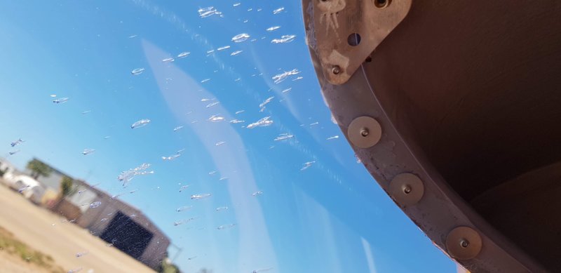

Thank you to everyone for your responses. In the main, mostly confirm my own thoughts and those of plastic sheet suppliers. -

The screen in the photo is a brand new polycarbonate sheet (with less than 5 hours flying time), installed as a replacement for the original screen. The factory used to fit polycarbonate as standard, but now also fits PET screens, which are more pliable but are a little more prone to scratching. The owner says that no fuel or other chemicals were spilt or used on the windscreen. -

Many thanks BirdDog - i'll put it in the mix -
I recently noticed this damage to a polycarbonate windscreen. Definitely not stones - the screen remains smooth to the touch inside and out. Questions: (a) anyone any ideas as to what's causing this? (b) Is it dangerous - ie might the windscreen break in flight? © How to prevent in future? All helpful comments gratefully received!
