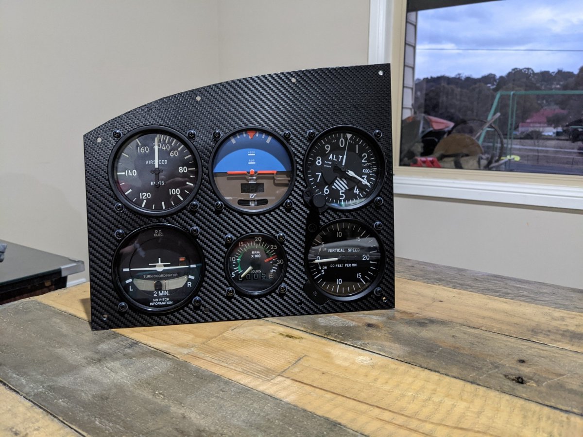

  1. Ya, I have the D3, use it as my backup to my Skyview HDX. Works pretty well, long battery life, takes a bit to fire up and calibrate after first start up.
  2. You could try James at https://swishprojects.com.au/

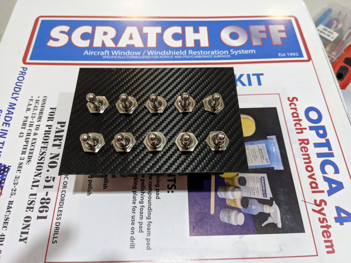

  3. The switches have a double nut on them, so I lined the front one up and did them up from the back, if I had to adjust the front I was just very careful. You can get plastic washers that size but I don't think I will bother with those for the switches.

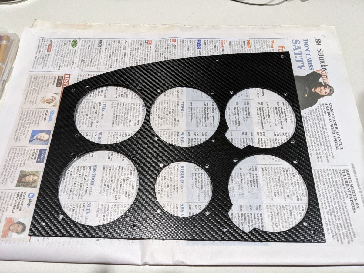

  4. I was very impressed with how it turned out, a bit fiddly, but worth the effort. The wrap is reasonably cheap too. I got a heap of little plastic washers for under the instrument screw heads and also under the dash panel mounting screws to stop any damage to the wrap.
  5. I am building a Zodiac 650 and I opted for the 3M Carbon fibre wrap. I also created a dash overlay that I broke up into several dash sections. Still a few bits to go though.
