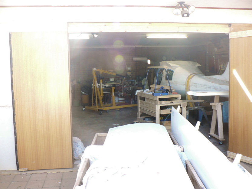

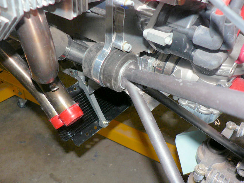

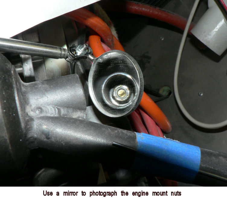

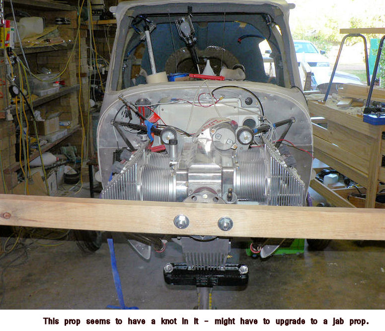

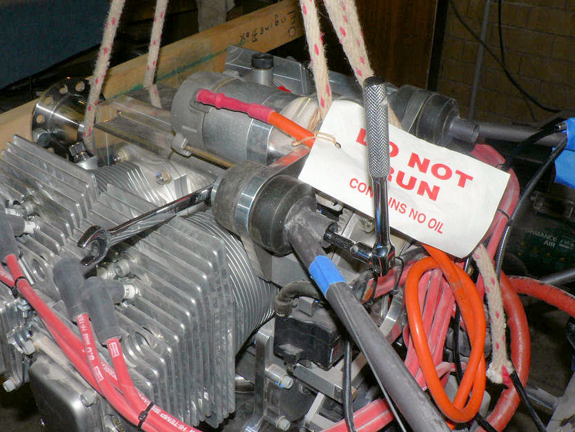

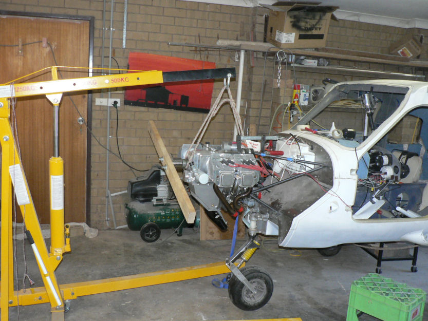

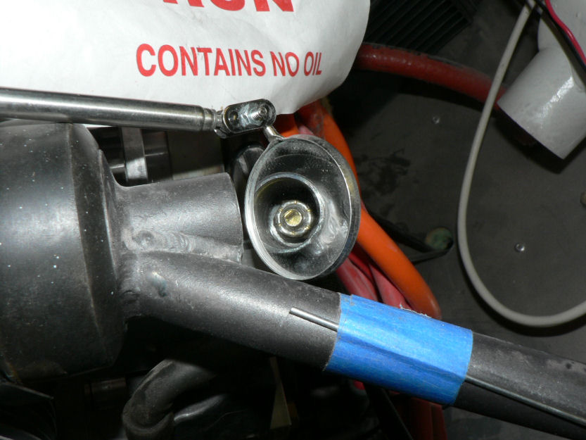

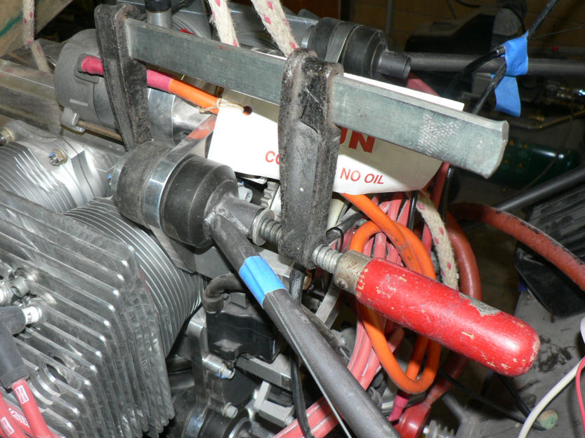

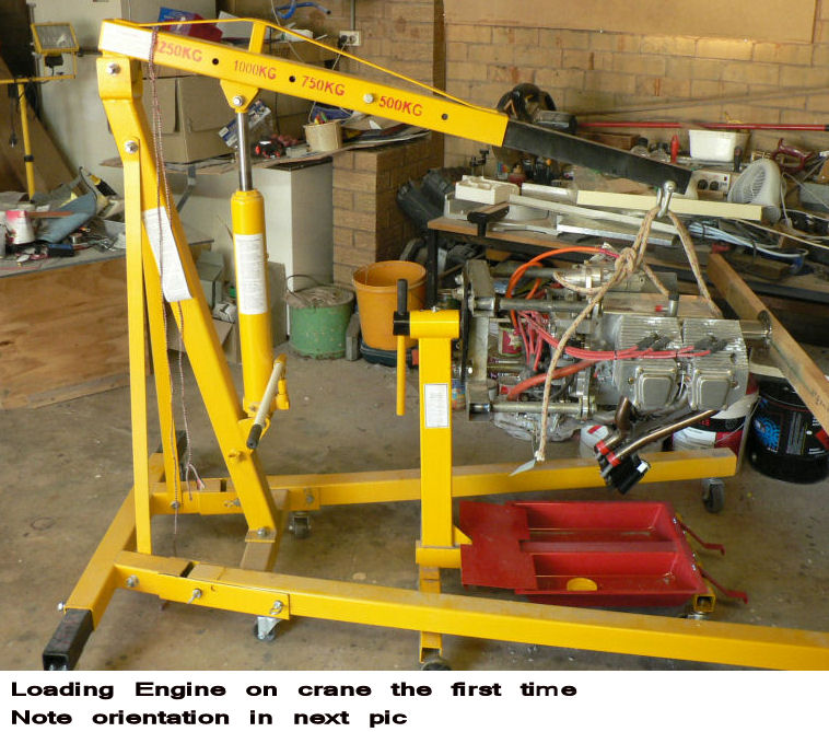

  5. 16-10-2007 Rearranged a/c in carport for engine installation. Lift engine Jab 2200A from engine stand with engine crane. Attach engine to engine mounts with washers and spaces and rubber bushes arranged as per Jabiru drawing - note top & bottom mounts use the same parts but are arranged differently. Used a 7/16" socket with a nut in it to hold another nut in place while the bolt is turned by spanner in the compressed rubbers and engages the hidden nut. See the pic. Once the bolt has started in the nut the clamp can be removed and the bolt tightened normally with a socket and an open ender or an offset 7/16" ring spanner. Put more air in front tyre to increase ceiling clearance from about 50 mm to maybe 150 mm. One of the lessons from this exercise so far - build a shed first.

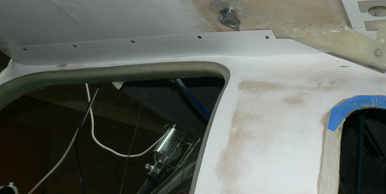

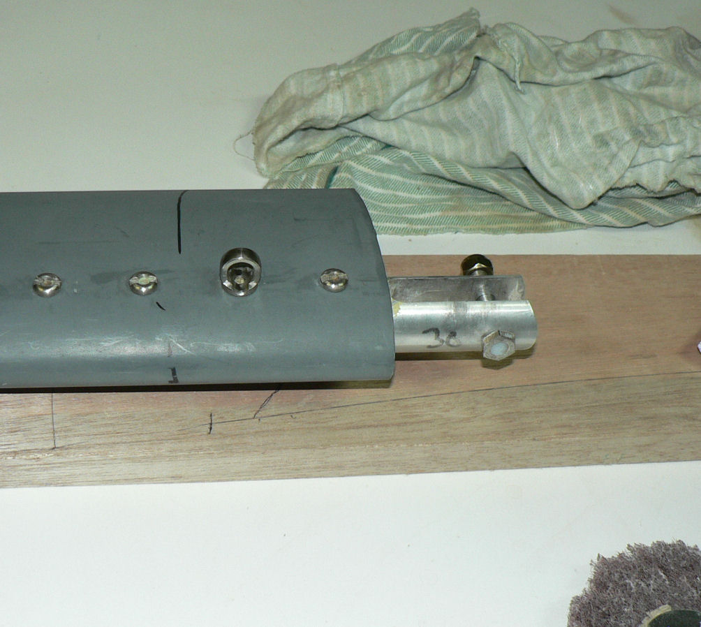

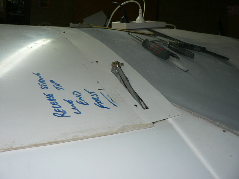

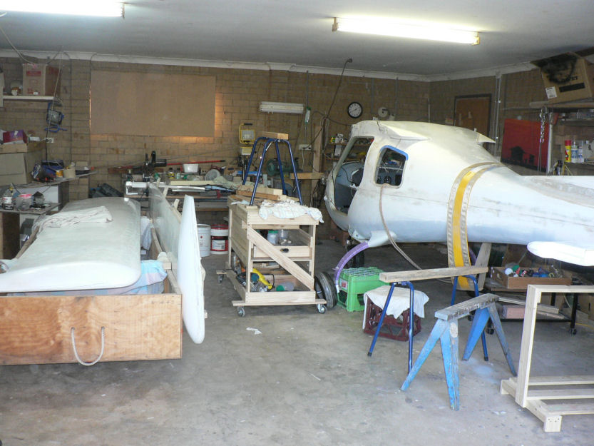

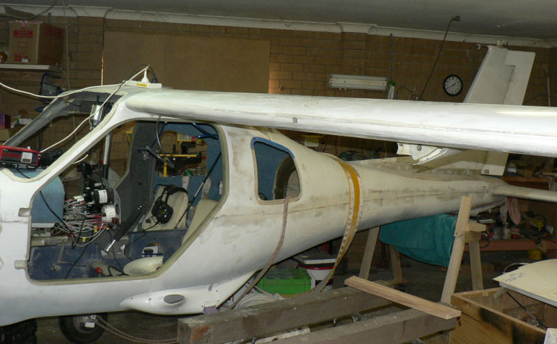

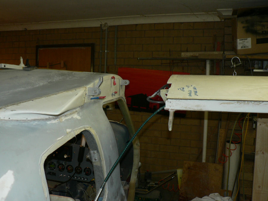

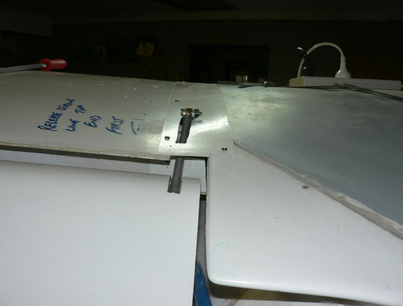

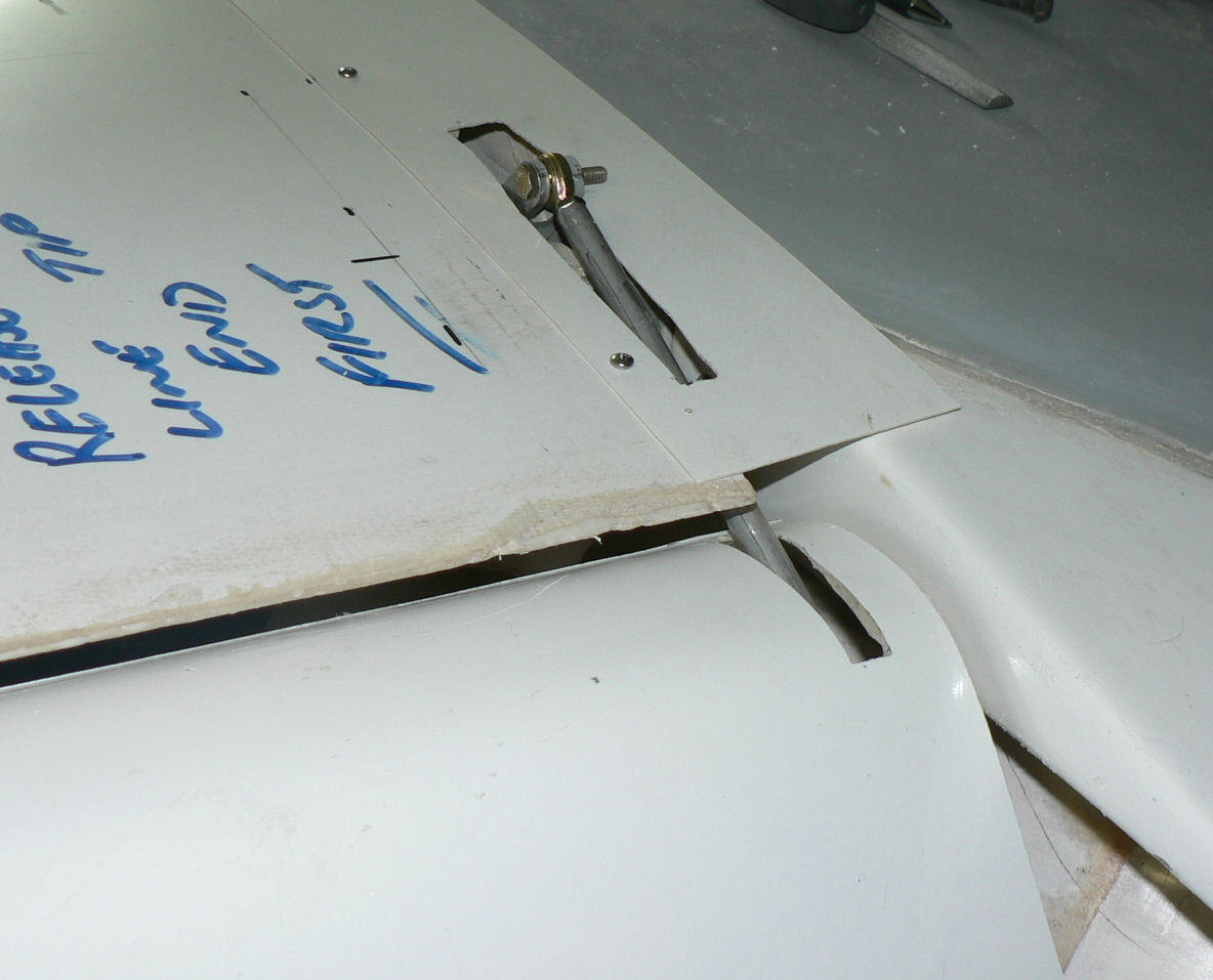

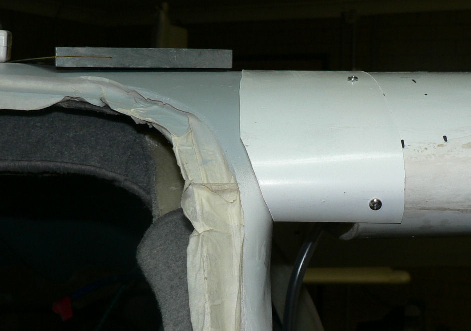

  9. 15-10-2007 Fitting cover strips to LH wing root area. Connect LH Strut to wing & fuselage & check fairings for clearance & adjust Cut top cover strip to fit & drill holes & fit self tappers Cut slot to fit flap arm & fit flap to LH wing Extend slot to suit flap rod connection. Fit & cut to match bottom cover strip' Drill & fit screws to match Check flap for full movement up & down Remove cover strips & remove flap Disconnect strut & disconnect wing from fuselage.

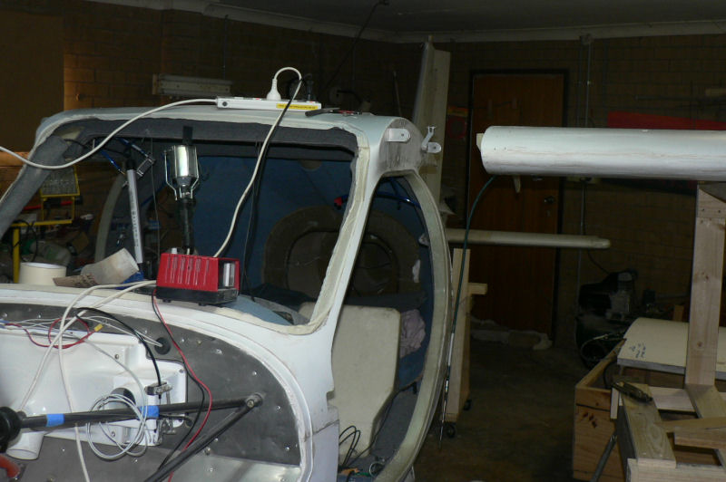

    Hi Geoff The following may not be relevant to your situation. But I set mine up so that my fuel sight gauges are mounted on stand offs so that I can get at their fuel line connectors from inside the cabin. I think I should have drilled a new set of holes through the cab wall into the wing root area so that the hoses can have a bend in them to make it easier to hook them up. I may have done it accidently for the LH gauge because I had to move it forward to clear the flap handle area. The attached pics may explain although not taken to explain that point. I epoxied nuts on the backs of the stand offs to allow for finger size! First Pic is a "standoff" not a sight gauge![ATTACH]3966.vB[/ATTACH] [ATTACH]3967.vB[/ATTACH][ATTACH]3968.vB[/ATTACH][ATTACH]3969.vB[/ATTACH][ATTACH]3970.vB[/ATTACH] I am yet to connect the complete assembly so may have to modify it a bit yet. All designers should have to do maintenance for a couple of years before they are allowed near a design office. Regards

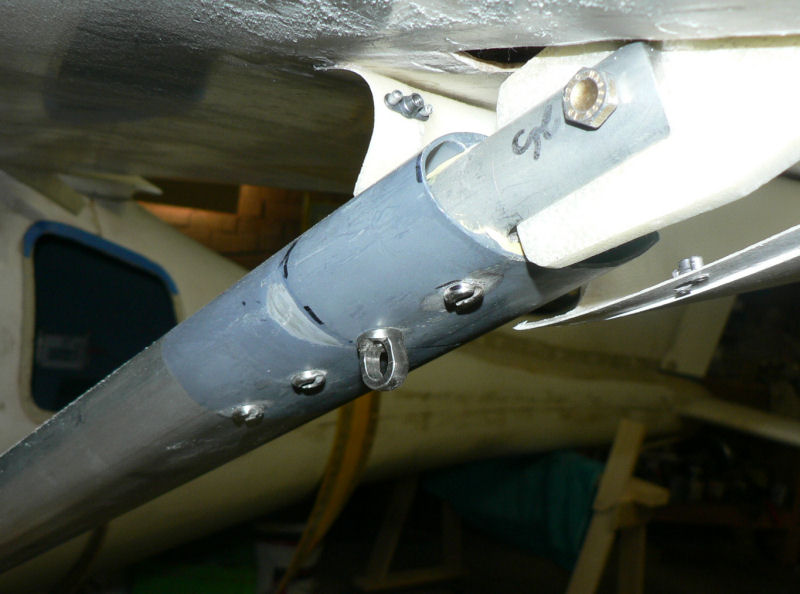

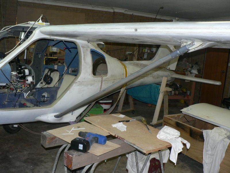

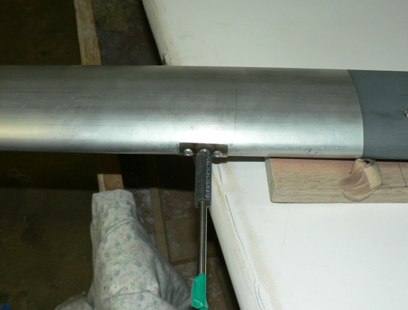

  12. 10-10-2007 Fitted Pitot tube to RH wing strut 300 mm from top end of the hollow part of the strut with plastic tube attached. Left about 100 mm protruding from bottom end. Fitted the SS tied-own eyelet to the second last bolt position on RH strut, the same end as the pitot tube. No tying ropes half way down the strut! Removed wing root covers from RH wing. Removed flaps from RH wing Disconnected RH wing from A/C. [ATTACH]3940.vB[/ATTACH][ATTACH]3941.vB[/ATTACH][ATTACH]3942.vB[/ATTACH] Cabin area next

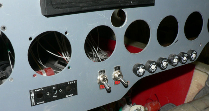

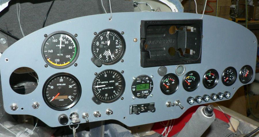

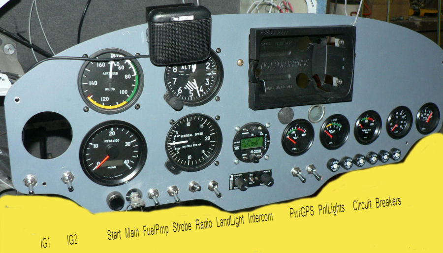

  16. 9-10-2007 Put a couple of extra switches in the panel. Checked to ensure the circuit breakers are included in the circuits. See the switch order in the photo below. [ATTACH]3939.vB[/ATTACH]

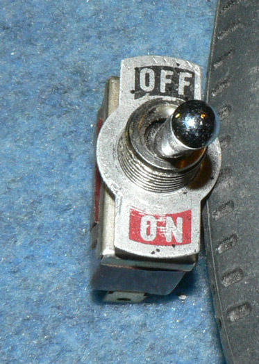

  17. 8-10-2007 Note the panel switches in previous days pics. The labels are marked the wrong way up for conventional aircraft panel installation. So have removed the labels and turned the switches so that UP is ON or CLOSED except for the two IGN switches on the far left of the panel. The IGN switches are set with UP as OPEN circuit i.e. not earthed. Down for the IGN switches is closed circuit therefore connected to EARTH which should stop the engine if both are closed. Drilled a hole for a Grommet under the GPS Caddy as it is a HAND held and not permanently wired in. This grommet allows the external 12/24 volt power supply cable to be plugged into a socket that is within the pilots eyesight range. Slotted the Caddy holes a bit on the RH side so that the caddy can be tilted slightly towards the pilot seat - about 4 mm. Could be tilted more by lowering the LH side of the caddy into the panel but this would entail more Aluminium panel cutting. A special bracket to tilt it more is available as an option. I am a bit worried about glare on the GPS especially after flying the J230c out of Narrandera on Sunday although it had a clear windscreen and my kit one is tinted. That should help. After hearing of the failure due to excessive heat of a GPS external aerial attached to the windscreen in one of the posts that I read on Sunday night I might paint mine white and attach it in the shade near the cabin roof. After all my old Magellan 320 will work almost anywhere in a Jabiru. Refitted all instruments (some of them twice:confused:) and wiring. Inserted extra switch on left of panel. Will do another tomorrow. [ATTACH]3930.vB[/ATTACH][ATTACH]3931.vB[/ATTACH][ATTACH]3932.vB[/ATTACH] I actually put lights in the instruments - so I could read the hourmeter & see something working. [ATTACH]3933.vB[/ATTACH][ATTACH]3934.vB[/ATTACH] Note blank time hours that you can read in a dim cabin[ATTACH]3935.vB[/ATTACH] Will have to check that circuit breakers are in the circuits. Panel was live in the photo with radio scanning traffic as far afield as Melbourne, Mildura, Dubbo and Mount Gambier. I don't sit in it and go brmm brmm! There is too much stuff on the seats and on the floor!
