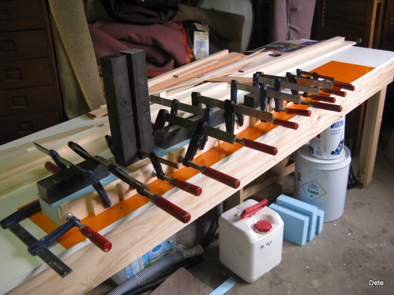

  2. Hi to anyone whose interested. I have made a little progress since I posted the last images in the 'Skypup' Photo gallery on this site somewhere, last year. The trailing edge stock has all been planed to a tirangular profile. I used some very nice straight Hoop pine in lieu of Douglas fir. I have also planed down most of the cap strip material 2.5mm from a flitch of imported Orford (?) pine. The remaining eight 1'' Dow foam sheets have been reduced to 3/4" for the ribs and fuselage sides. I used a hot wire mounted in a rigid 3/4 spacer over the bench and pushed each weighted sheet along under it; each cut taking about 25 minutes. The spars for the empanage group have been fabricated. ie. Fin post and LE. Stab LE and spar. Rudder LE. Elevator LEx2. I have also made tree control horns from 2024 t3 Alclad sheet. Having trouble understanding how to load images here. So they will be in the Skypup album. Cheers Dete

  6. Hi there all, I've made a little progress over the last two weeks, in spite of the cold temperatures here in Sunbury. Not to good for gluing. Still working on the spars. After making cardboard patterns for the webs and and tracing them onto the Birch ply, I then removed the bits that didn't look like a Skypup with the jigsaw. After gluing the webs on one side only, I trimmed them to size with a small plane. There are some new photos in my Skypup gallery which show better than words can say. The long reamer was an idea from a model engine friend. It was very useful in aligning and sizing the quarter inch holes exactly. Used at low speed and kept very sharp with a fine diamond ezi-lap stone. I'll repeat the gluing and match drilling for the webs on the opposite sides next. Building a plane is all consuming at times but I'm really enjoying it at the moment.:big_grin: Cheers
