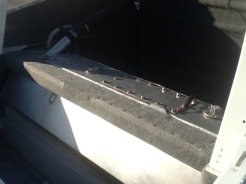

Hi all! new throttle spring arrived from Vans today,there is a great deal of tension difference between the new and the original Rotax ones,happy to report that after a 45min flight ,happy to report no throttle creep at all,also it has made the throttle so much lighter as not as much friction nut is needed.also have attached the alternate fuel tank we made Cheers Raizo
