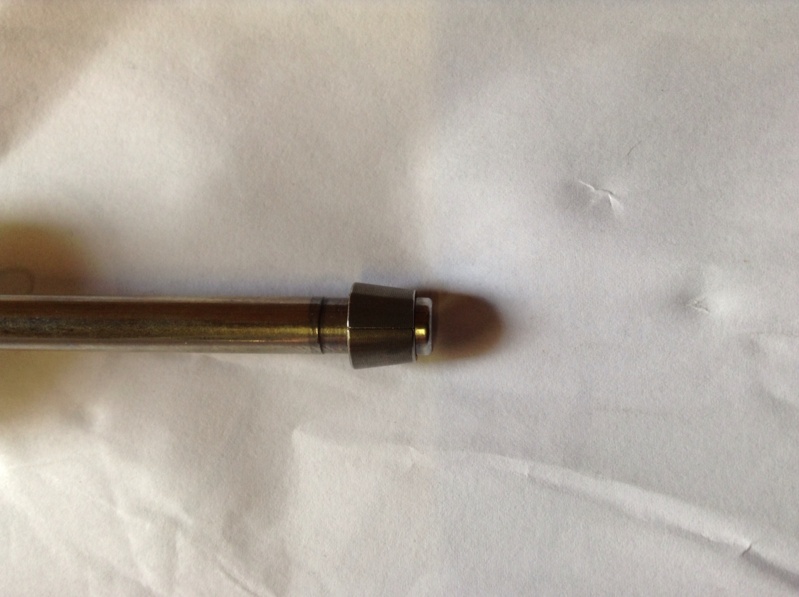

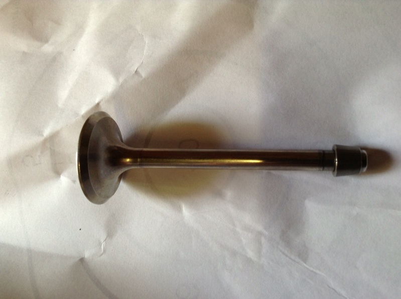

  2. I checked the old ex valve from the spare heads i bought and the collets completely close around the valve, now this motor has not had the valves changed, its serial no is towards number 2000, waiting for the exact number, i got 2 complete heads, 1 barrel and 1 complete piston with rings and pin. My original plan was to drop 2 and put these on then drop the other 2 , im now going to drop all 4 at once, so will prob re sell these parts
  3. Well spotted, i just slung them on for the photo to check for a gap
  4. Attached is pics of the new valves, the collets close completely around the valve and the valve rotates within the collets, these came from skycraft UK there is a step just below the collet were it looks like the last bit has been machined down as smaller dia than the valve shaft
  5. I bought the valves from skycraft, i am replacing the barrel with a fully serviced unit from Roger, i also bought 2 fully serviced heads as well, so at the end of the job I will have all these parts available for the future or if any one else wants them
