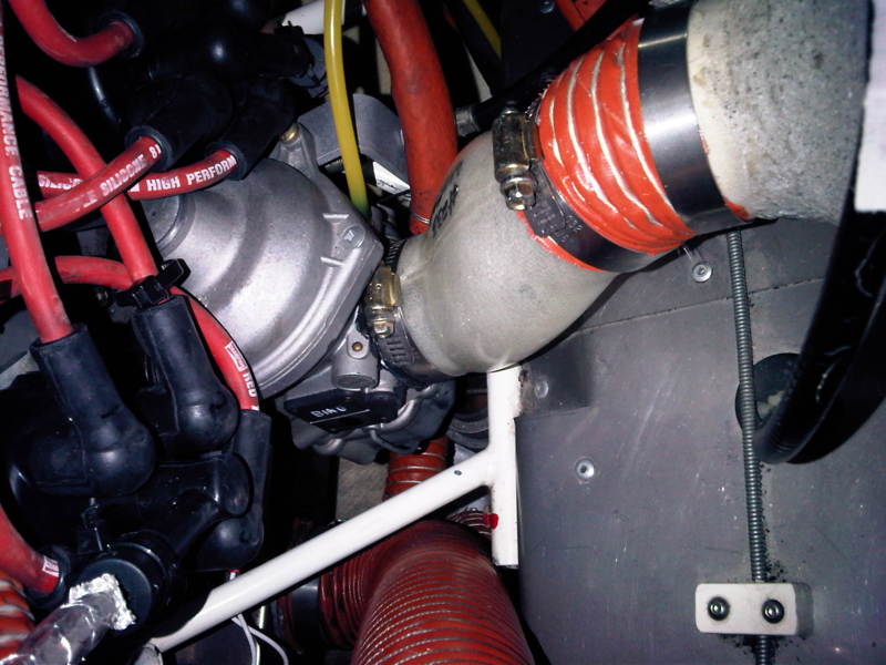

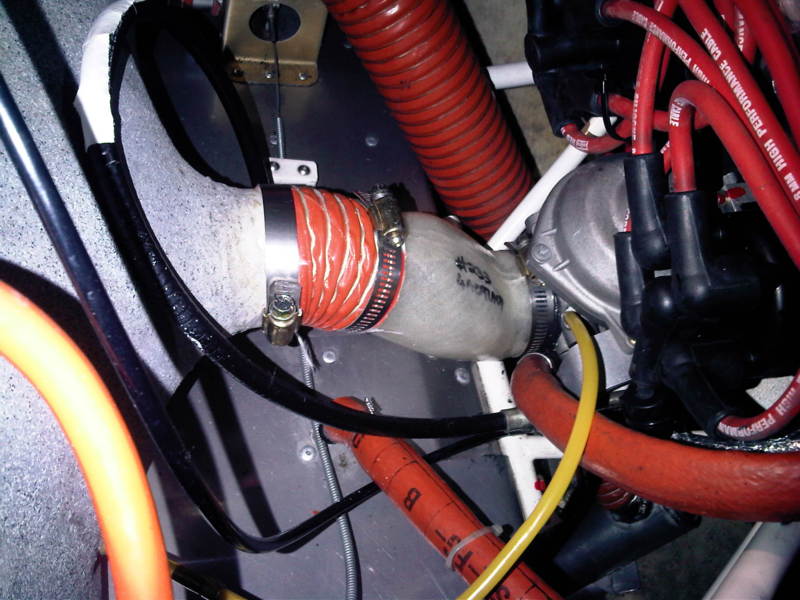

  23. was a long time to fit. I took the air box off and radiused the part were the out let pipe goes inside as this was sticking through, I did a trial fit, it could of done with a little bit more of an up sweep as quite a bit out of line to the airbox. I re cut the scat hose using the middle bit of the old 1, fitted the head, quick measure up then fitted the scat to the airbox, I could then not get the cobra head on the carb, so after another 2 cuts to the scat I managed to get it on. I nipped up the clip to the cobra head carb end but the head still remains slack on the carb, there is no saw cuts in the head. I did not want to add saw cuts so I stripped it again and put a bead of loctite black rtv type silicon (hight temp fuel resistant) around the carb then reassembled the whole lot again, this time the cobra head is sitting on a bed of silicon, not sure on how important it is to get an air tight seal in this area, but is should be OK. next time its removed I will prob beef up the cobra head in this area and add some saw cuts in it the beefed up bit should stop the saw cuts migrating.
  24. Bugger, mine is tilted the other way
  25. so top of carb to the rich side
